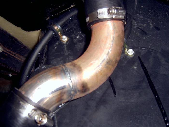

I tried to get something flexible and ended up at Enzed. They said the only flexible thing that would handle fuel was marine exhaust tube. I got some but it was not flexible enough. Ended up making this up:
http://www.clubcobra.com/photopost/d...FuelFiller.JPG
Geof

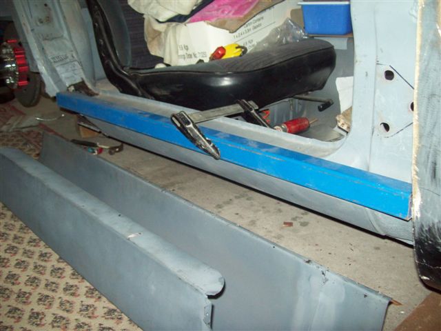

I have placed a 40x40mm tube along the existing sill so that it contacts the base both the 'A' and 'B' pillars
https://i.postimg.cc/Hn7Bm035/101-7350.jpg

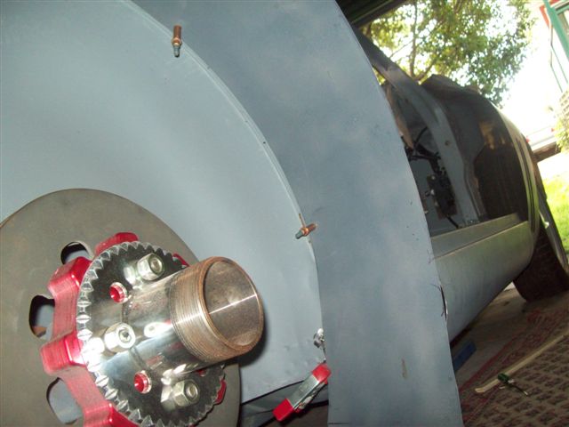

I removed the outer portion of the rear wheel arch and trimmed the guard opening to suit.
https://i.postimg.cc/LX5xCF1x/101-7353.jpg

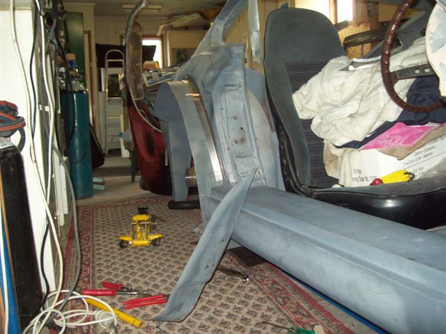

I attached the new (wider) sill.
https://i.postimg.cc/MZMSHhF0/101-7343.jpg
