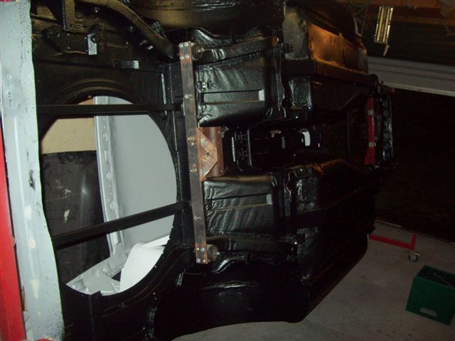

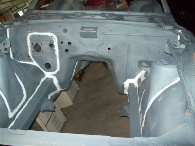

A bit worried that the media blasting may have removed some sealing, along with the fact it is 40 years old and there are many panel modifications, so I'm doing new sealing prior to painting.
Engine bay done, now for the underside stone chip.

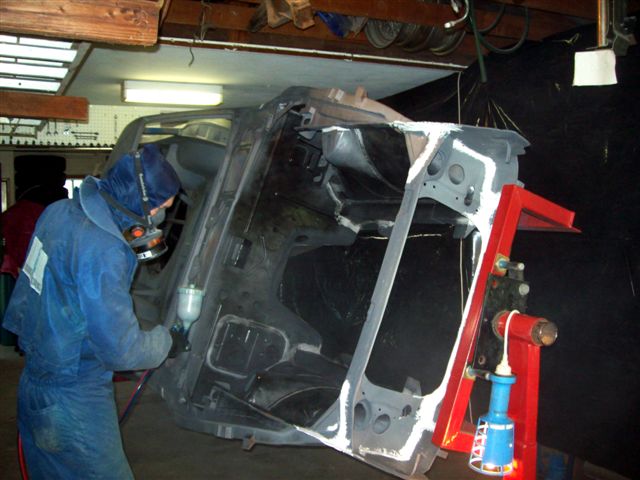

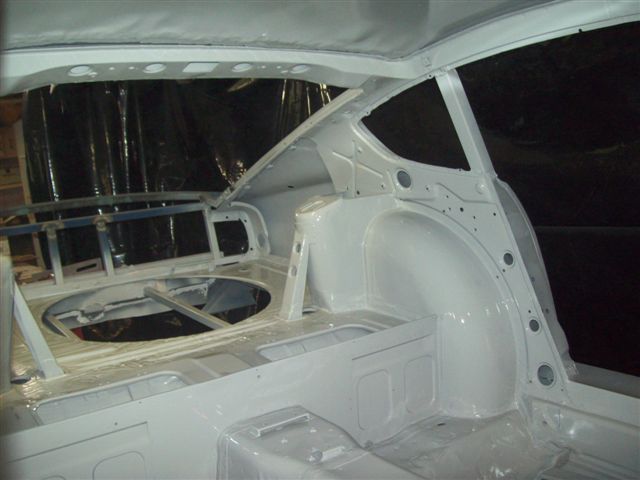

I got the interior painted yesterday, and
the stonechip on this morning.

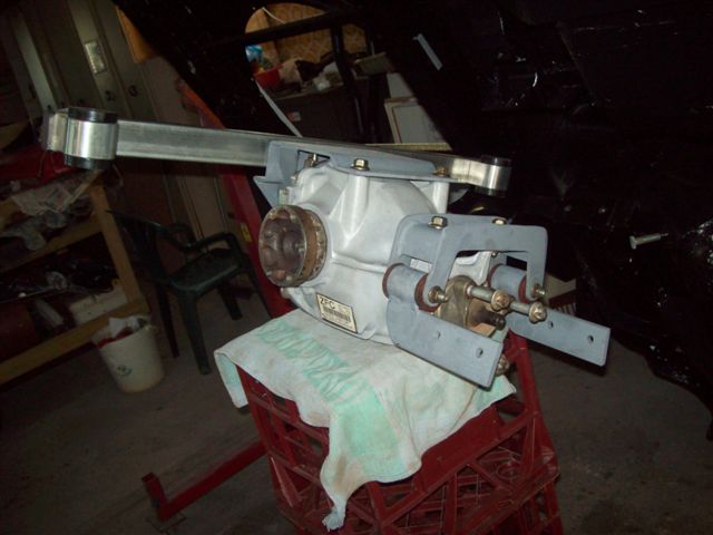

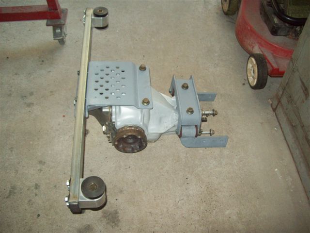

I have settled on a final design for the GM IRS diff installation. It is attached to the original four Datsun mounting points - two at the rear of the transmission tunnel and two spaced apart on the rear cross-member.

Some nice engineering in there Peter. Well done.

Thanks Mike - I hoped there are some out there who find this thread of interest.
Fitting the drivetrain has required some precision due to its bulk compared to the original Datsun items. The jurid coupling between the diff input and the tailshaft leaves little clearance with the new front diff mounts which subsequently have to be secured in the transmission tunnel with countersunk bolts. Unfortunately no bolt supplier had 10mm countersunk bolts with a fine pitch – 1.25.
I purchased longer (75mm) coarse pitch bolts which had a plain shank portion and machined a fine pitch thread into the shank area and then cut them off at 25mm length. Just one on those many many time consuming issues which come up with these builds.

I always find what you are up to interesting. Good to see posts about building cars.
Those bolts are one of those little things where you think it will be a simple job of bolting on only to find many hours work required.

Me either - I actually created the countersinks on the wrong side of the brackets and had to weld them up and re-machine on the correct side. Like the kids tell me - too old, too slow, too stupid!

Great job Pete, I love the use of insulators in the mounts.
Jag rear ended Cobra's should have this.
