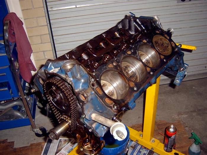

More Progress
I now have the engine down to the short motor and have been cleaning the carbon deposits off the top of the pistons. It hasn't been too bad, thankfully.
http://www.clubcobra.com/photopost/d...ium/short1.JPG

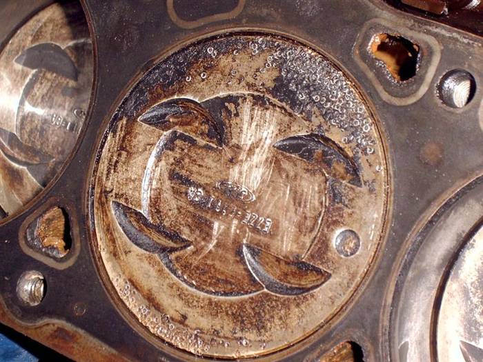

However this, on No. 2, is somewhat disturbing!
http://www.clubcobra.com/photopost/d...edium/No_2.jpg
I suspect that this is a sign of some detonation. The bore looks (?) OK but this will need to be removed and replaced, so it looks like I am up for an octet of pistons!
Geof
bobcowan 07-11-2011 06:29 AM
Be sure and check the rods very carefully. If that's from detonation (and I'm not sure it is) the rods and crank have been taking a heck of a beating.
That new long block is looking better every minute.
boxhead 07-11-2011 06:34 AM
Looks to me more like foreign object damage.
Are they dents or holes?
Dents will be a little like a crater with a raised outer edge (very small raise where the alloy is "bruised")
blykins 07-11-2011 07:03 AM
If you would have had that much detonation, the spark plugs would have told the tale. Check #2 plug for aluminum embedded into the end. The #2 rod bearing will probably also be hammered if detonation was the cause.
I think you had something get into the combustion chamber and then was bounced around.

07cob 07-11-2011 11:44 PM

boxhead
The imprints appear to be dents. The visible circles in the image above are the raised outer edge of the crater.

Rob. Smith 07-12-2011 04:18 AM
What does the head look like ? If the little "centre punch" marks are on the piston and it's supposed to be a loose object there must be some marks on the head. The marks are on the top and bottom of the piston only ! Nothing around the valves ? I first thought detonation but everything is too clean and the bottom of the piston wouldn't have those marks either. Strange...they're very consistent ...same size and shape.

Gaz64 07-13-2011 02:42 AM
A bit strange the foreign object damage only limited to one cylinder, and the number of times it has marked the piston before it finally went out the exhaust.
