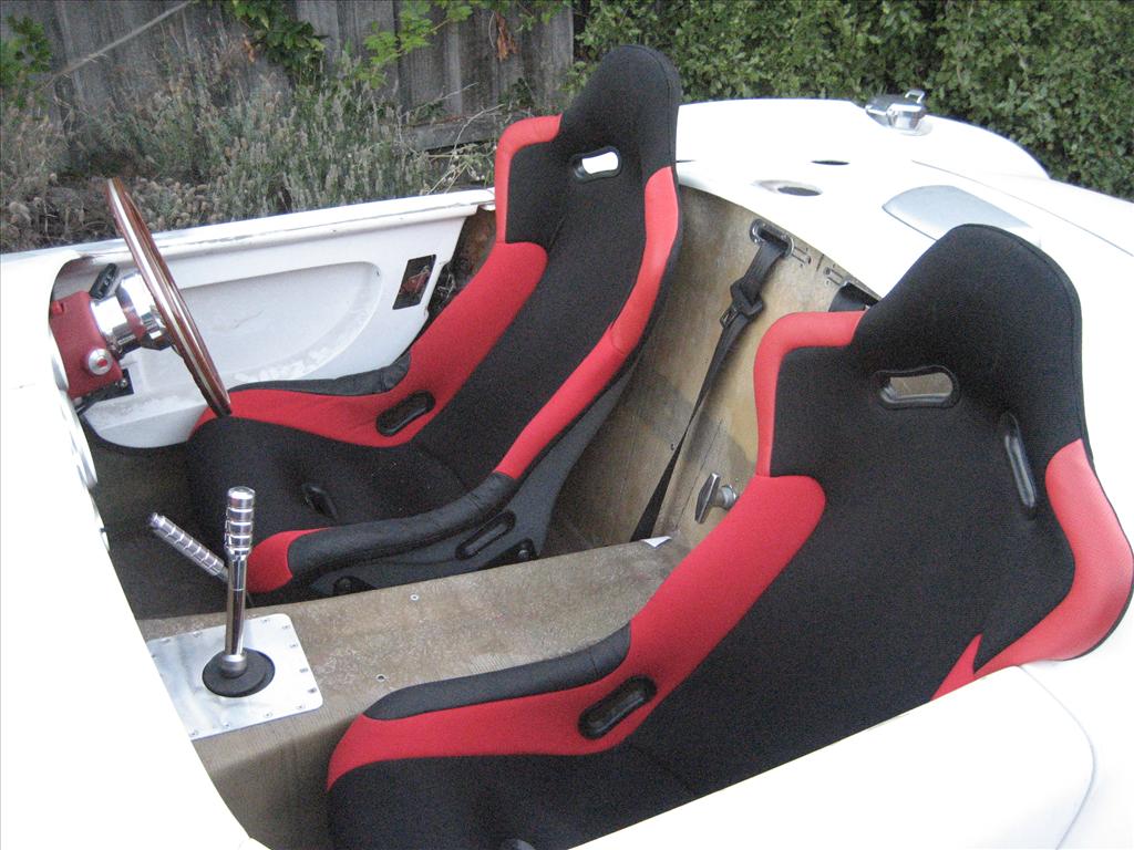

Hi Guys,
anyone have any experience in installing seats like these Velo GP-90's?
I see these ones are ADR approved as well so have some appeal. Of course I need the XXL ones, and I believe they will fit at floor level, but the query is really how the wings etc will fit in.
Thanks
Tim

I have something similar in mine. I had to cut some notches in the sides of the wings to make clearance with the top of the door. I also had to trim a bit off the front corner to clear the tunnel. The good thing is that the I could cut and mod them and then just slip the covers back over and you wouldn't know they'd been modded.
Mine were ADR compliant and I went through rego with them.

I'm running the same type.
Had to do the same thing as mike.
I took a fair bit from the shoulders and also had to take about an inch out of the side of the base on the passenger side to get it past the tunnel.
Just took the cover off made the mods and put the cover back on.

The seats are made by AutotecnicA and are available Locally. An Autobarn near you probably have some you could try out for size.
AutotecnicA.com.au » Seats, Race Seat, Monza Seat, Racing Seat
The model number is A1098
One good thing about them is they don't come up as high in the hip area as some others. I'm 6' and 100KG and they don't fit me too bad where as many others are a squeeze.
If your local shop doesn't have on on display I'll drag one out and take some measurements for you.
