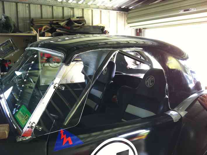

I have seen one up here with a slot cut in the hardtop for the roll hoop and an air extraction vent glassed over the slot.

I had to mod the roll bar in mine quite a bit to get it to fit under the roof.
Mine is now verticle rather than set back 15deg as CR's normally are. I didn't change the mounting posts just put a bend in the bar below the body line.
It is above head height, yet still under (just) the roof.
Looks crap though, it won't stay on when the top is off!!

Just thinking about your comments regarding your hardtop adaptation. Considering the way my DRB roll bar is designed it might be practical to remove it when the hardtop is on rather than modify it and possibly cause more harm than good? I'll wait and see how it all comes together but it's nice to know that removing it (if only for a short time) could be a legal option. Alternatively it might make more sense to have another roll bar made that just fits under the top. Gotta be better than nothin if this happens  ...  ..

I will make another roll bar for when the top is off. My top however won't be off very often.
