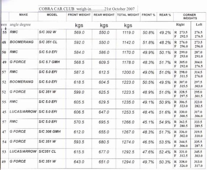

Here is a list of WA based cars and their weight for comparison.
Mostly all with iron blocks.
Don't know if the weights include the driver though.

Interesting...only 3 of 14 are nose heavy. One is running a LS engine perhaps others have aftermarket alloy blocks.

Nope, all iron far as I know.

Curiouser and curiouser....
