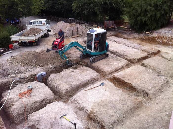

The big escavator dug through the 2 meters of rock at the back corner.
The little one cleaned it all out and had to dig the front trench 2 metres deep to get to the original ground level.

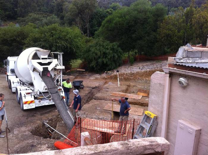

Took 17 metres of concrete just to fill the trenches to 500mm below finish height. (did this to stop any cave-ins, as rain was on the forecast).

Holy crap, those footings are enough to anchor the Titanic.

Cobra Make, Engine: have brakes, diff, gearbox, steering rack, gear stick, door locks, CR chassis 3518
Posts: 91
You sure its not an archaeology dig site?

Ready for another 26 metres of concrete.
The two back walls have been engineered to retain 2.5 metres behind them.
This explains the wide footings to the back and the massive amount of mesh and bars.

In Australia you have a local planning code to adhere to, and the building permit and engineering are done separately.
Got the plans through the local council without issue, as size and setbacks were all within standard specs.
The engineer went to town with the retaining walls, they are 300mm thick at the base, and core filled to the roof with vertical rio every 200mm and rio along the whole length every 2nd coarse of blocks. And as you can see it all ties back in to a huge amount of concete in the slab.
So to answer the question: yes it is to code (but I think the engineer has gone to the extreem a little).
