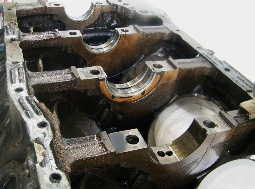

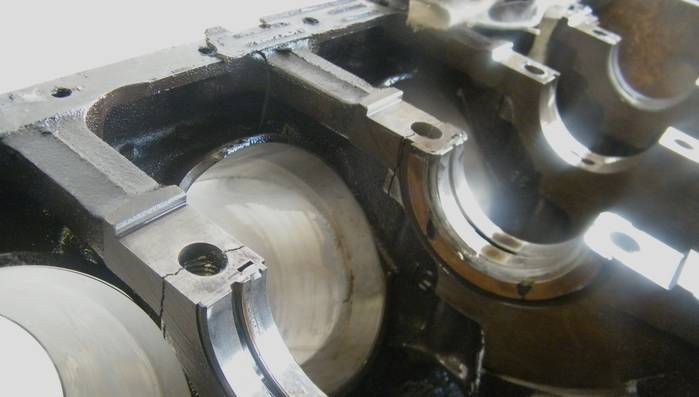

Where is that pic of Wazza's split block.
Cruising in 5th
  #35 (permalink)
Old 11-03-2012, 12:49 AM
Wazza's Avatar
Join Date: Nov 2006
Posts: 1,683
Here's the little darling !!!
LUCKY for me it had a GIRDLE fitted......
I would have been looking for all the bits for hours !!!!
The Dart Block that replaced it was the GO !!
And...The Four Bolt Mains look like they do a much better job than the pissy little Two Bolt caps...( Sitting on top in the photo )
Warren.

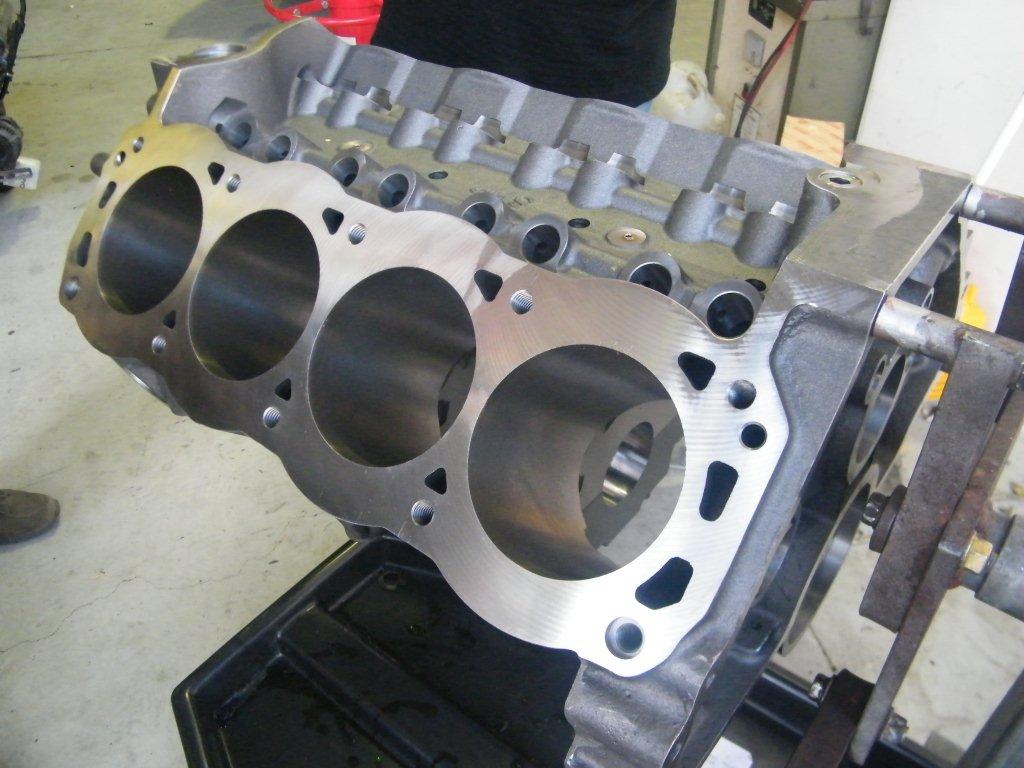

Posts: 227
Thanks for the pics Wazza, great comparison with the mains caps.
Originally Posted by tomcat racing View Post
the dart iron eagle block is even better, its 4 bolt caps all the way.
TC, I am assuming you mean at the front and rear mains caps as well in this pic...
Now, I do not think the 5.0 HO has a 4 bolt mains...(any info here?), but if not the mains girdle should help...or is there a mob out there that can machine in extra bolt holes and webbing profile for a compatible 4 bolt mains cap....or are we looking at sourcing a block with this done from the get go..
Thanks Adz

Old 11-04-2012, 12:04 AM
Aussie Mike's Avatar
Location: Sunbury, VIC
I don't think there is enough material in the webbing in the stock block to be able to machine them for 4 bolt caps. In my opinion it would make the block weaker.

Hi Ice,
I'm not sure what you want from your new drivetrain package, but since your drb kit seems to be the same as mine and I have recently had a 347 conversion completed, I thought you may be intereseted in my reasons behind the decision to go with this setup.
Here's a pic from my 347 bottom end.
The block came from a 91 stanga It's had 3 hard days on the dyno plus 2000klms on the road including a 1500klms round trip through the snowy mountains on the weekend without an issue. The rev limiter is set at 6500rpm and I don't think that it will spend too much time up in that range as peek tourqe is at 4700rpm.
My position is that although the thicker blocks (like the dart) give you some extra rigidity etc, they are not really essential when building a street donk that will do a little track time. The obvious weekness is in prolonged exposure to high rpm consistent with track racing. I decided that for me, it was more important to have a mildly lumpy street motor with quality internals than an ultimate screamer that can endure consistantly high rpm's. Another option if you would like to stroke you current block could be a 331 kit? Ofcourse you would have to have the block tested as mentioned by others.
The other significant factor in my decision was that I wanted to use the same block so that all of my documents remain current and there was no need to complicate any of my engineers documents.
My 2c

Thanks again Mike and absolutely a good point.
Thanks also for the info on your set up Toe Cutter (thats so original Mad Max/Road warrior.... I like it), I am definately leaning for the 347 set up (is the 363 the same stoker kit but with over sized bores and pistons???), and definately want to use the same block that I have all ready for the reasons you highlighted.
This main girdle looks to be the way to go, noting the above and Mikes recommendations.
Thanks for the help with this guys, I am learning lots about this car now, and some good best practice recommendations are coming through loud and clear...so Cheers...Adz
