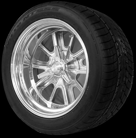

Has anyone got these wheels fitted to their Cobras? Pricw seems reasonable for a custom built wheel.

Looks to me like limited back spacing is a problem.

I have them... got them from Wheels For Less. You can pretty much get any back spacing you need. Took about 6 weeks to have them made

Have the American Racing (Shelby) 15" knock off rims on my Backdraft. Not sure what your driving? Going to 15" was expensive and involved process. Had to replace rear brake lines, rear brake calipers, two front knock off peg drives and two front peg drive axel caps. Very happy with the American Racing rims and the look!

They look like a nice wheel, although the 17" version introduces a "step" in the rim. Painted centres are a bonus too.
The 17x8 with 4.5" max backspace (offset) is not enough for the Harrison - needs to be about 10mm more in my experience.

I like the Reverse lip offered with these wheels.
Looking at 18x9.5 & 18x11 with 160mm backspace.

Thanks guys, I am after the soft lip with the traditional Halibrand centre as in the VN427 from American Racing. These ones (Vintage Wheels) have the traditional stepped lip, they look nice, just not the look I am after. Also I need the 18" for more tyre range and to clear my brakes. Think I have found the Australian agent, will see how the price stacks up.

I have have the VN427's 15x10 and 15x7 (polished rim and grey centres) fitted with 295x50 and 235x60 MT tyres. Front and back are zero offset and I am running Jag series II suspension front are rear. The rears still have plenty of clearance on the hub lower mounting boss.
I bought them via a local Adelaide dealer who dealt with Wheelboyz in QLD.
I did have an issues with both Wheelboyz and local dealer stuffing up my order by ordering in the wrong stud pattern. The tried to tell me that AR didn't supply the rims in 5x4.75 pattern and tried to stick me with the ford bolt pattern. The even tried to bull**** their way out of the stuff up by stating that AR hadn't "finished off" my order and this is the way that they do it(?) WTF!
In the end, I had to live with the rims being machined and fitted with stainless insets to bring the pattern out to 5x4.75.
Apart form this, I would buy from AR rims again and I am extremely happy with the rims and tyres. The look the part.
