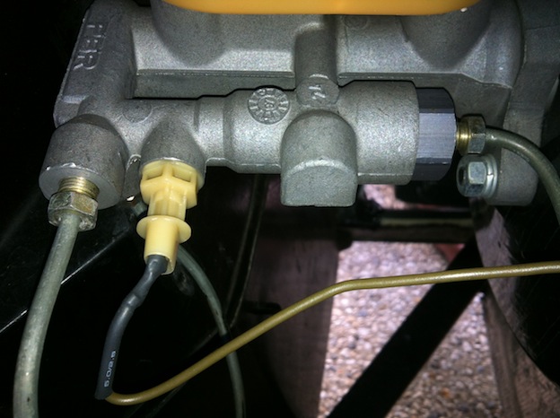

Is this the one you have? My Ford (wagon) one has a small screw underneath that can be released and needs to be correctly positioned to ensure the piston does not stick.
Merv
