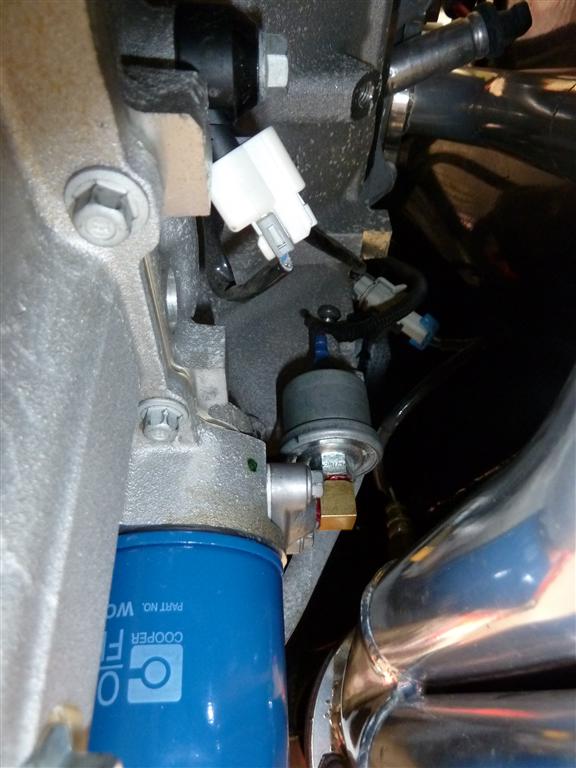

Here is a shot of the OE filter on my LS3, sticks down 80mm, doesn't appear to have a part number on it;
Ben in AU

Thanks guys. The low profile isn't really the issue, it's the centre hole diameter and thread size. Thread is definitely not the same on the C6 LS2 sump as I tried fitting a VE Commodore filter and it didn't work. Not sure whether it was LS2 or LS3 though.
I'm dumping the oil on Saturday so worst case I'll visit the usual outlets with the old filter and report back findings.
