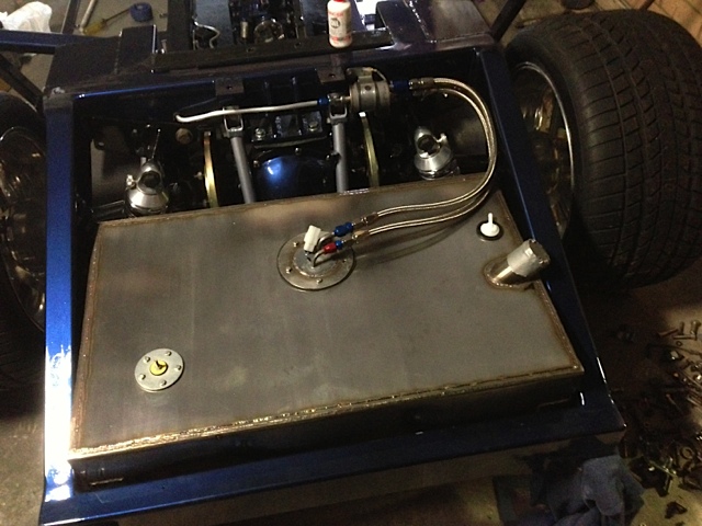

I am running that exact filter.
I have a Walbro 255LPH intank pump running to the filter with AN6 and then 3/8 hard line to the engine. More pump options with that filter/reg.

Zedn am I right in saying that the feed to the filter is 3/8 (AN-6), while the return from the filter is 5/16 (AN-5?) ?

3/8" in and 5/8" return, but all are -6an. Get the kit that has the fittings with it. I just used a tube nut and sleeve to go straight onto the 3/8 hard line to the motor. Then 6an hose to the tank.
I got all the stuff from summit.
