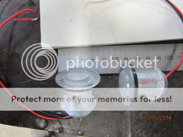

First photo below shows the design, which I like as it allows screw attachment into quite a depth if needed. However the lights aren't a huge diameter and will sit quite flush.

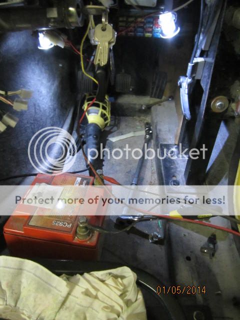

The second photo was taken tonight after dark and so the lighting is just the two LEDs. Perhaps a bit bright but clearly effective.
Was thinking of having one installed on each side of each footwell as part of the trimming process. I might play around and see if just one light suits.
I do plan on two lights in the boot so that the whole boot space is lit up well. This is the sort of space where too much light isn't an issue when you are searching for something.

Hi Steve. These are exactly what I was after for boot and footwell/glovebox lighting. Thanks for the link. Did you purchase the cool white or warm white LEDs?

Anyway George they are cool white light I believe, so a white - blue colur tinge over the yellowish warm white look.
