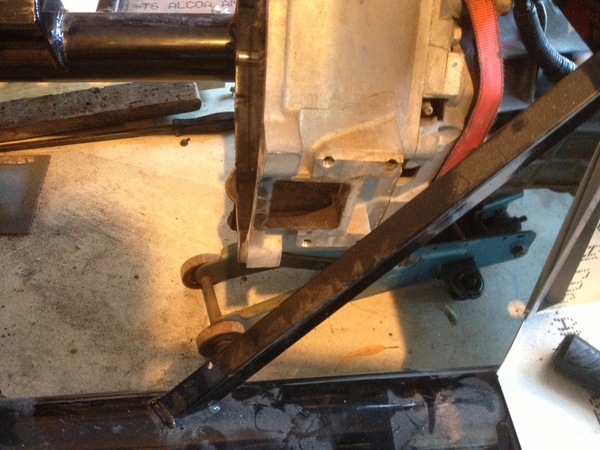

Well been crazy busy with family visits and such but finally got back into today by dropping the body on to see where the motor was going to sit. Unfortunately it was sitting too high because the intake was pushing the bonnet up by an inch or so out with plasma cutter and mig and managed to drop it by the required amount and still left about 4mm clearance on the harmonic balance thus far. And now that's where the real fun began starting with the gearbox, I mounted the box outside the car and then proceeded to drop it in as one unit (But) the box is so damn long I couldn't get it up on the rear crossmember and clear the tunnel/firewall and to top it off the OHC's were hitting on the front body support rail.
So messed about for several hours trying alternative solutions but came up short or should I dare say long Lol. So separated the gearbox and shoved that up into position strapped it up dropped the motor back on the floor shut the shed door went and sat down and just cracked a can because tomorrow is another day.

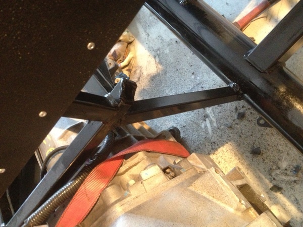

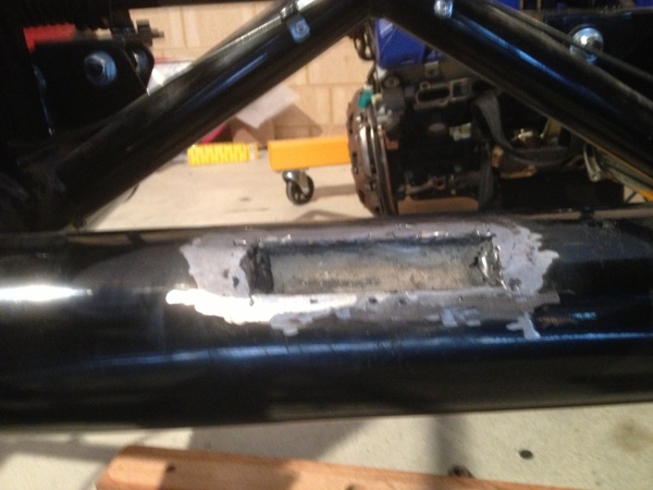

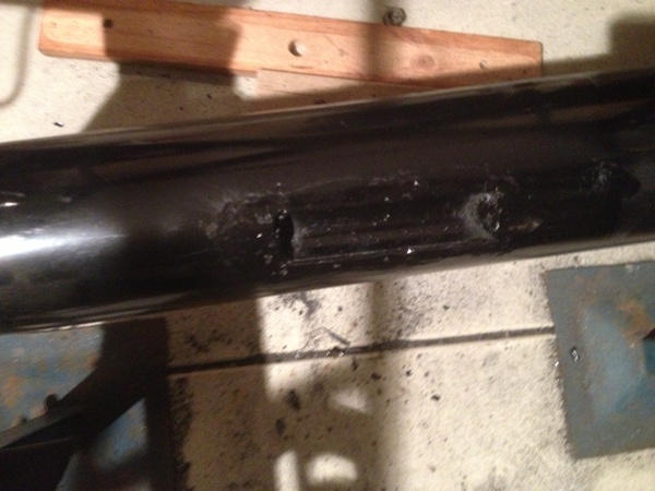

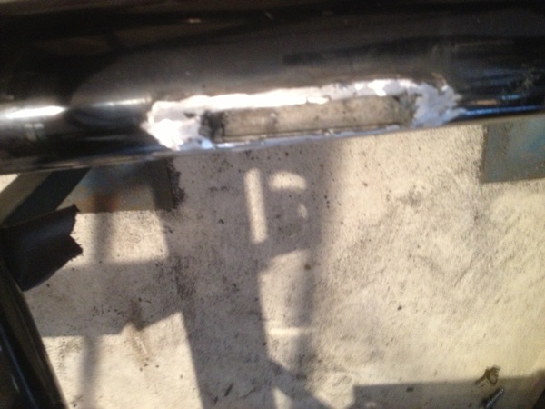

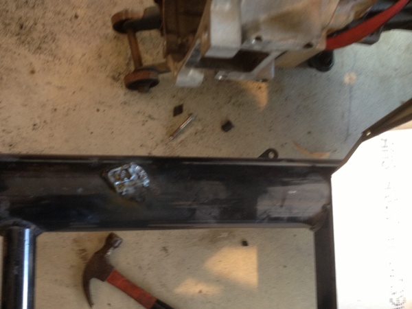

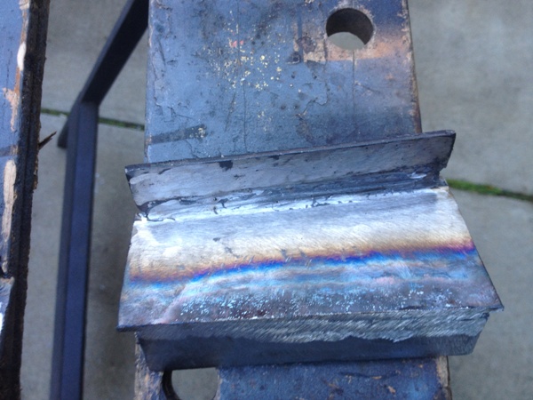

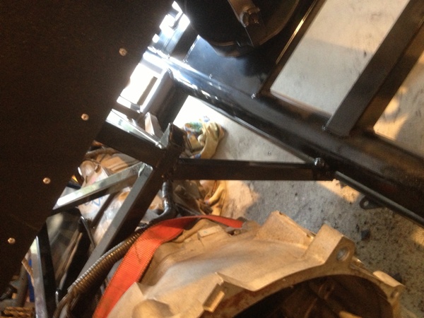

So today after having a good look at the front crossmember i could see that once the gearbox is hooked up i reckon the harmonic pulley would be too close for comfort so i thought it would be a good time to notch it out some.

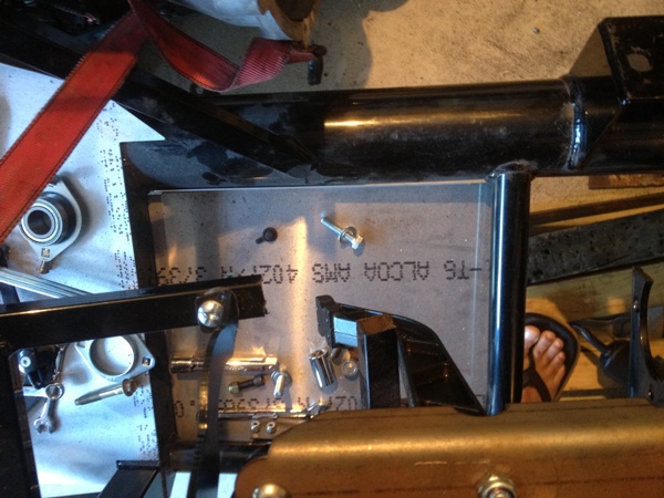

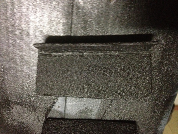

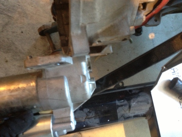

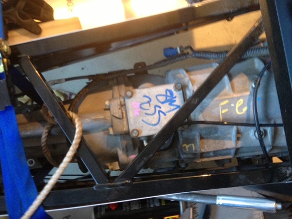

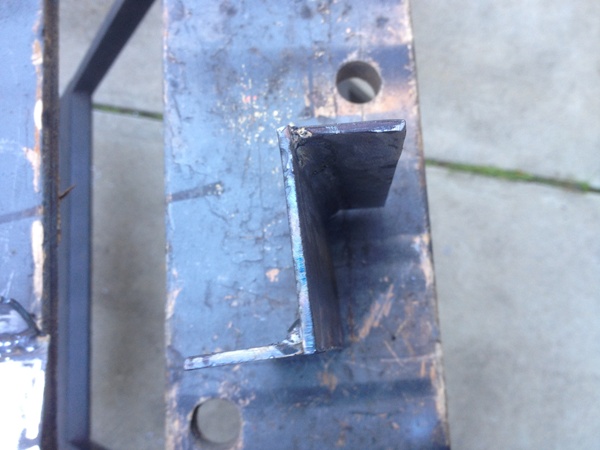

Ok so a few modifications today first was the pedal box support that was way too close to the head/ rocker cover

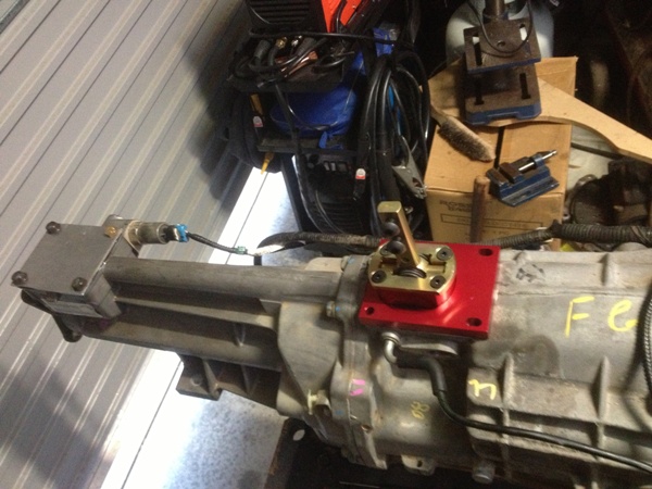

Then had a look where the gearbox will finally sit and that’s not looking good at all so I will need to look at maybe a remote shifter or modifying and relocating the shifter to the inspection plate or as Mike pointed out maybe changing out the rear housing.

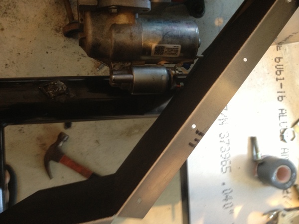

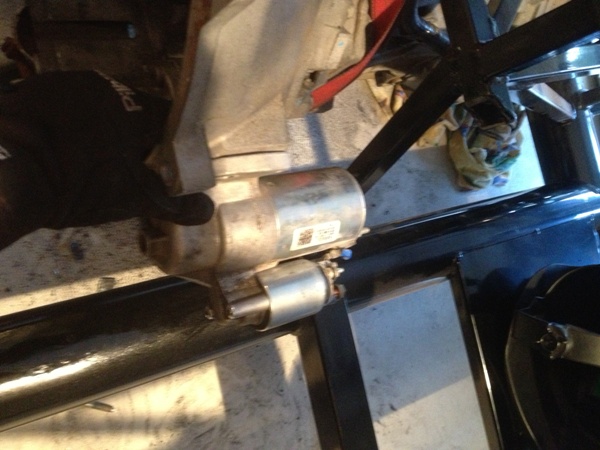

Now to look at the passenger side and low and behold the starter motor is the next issue looks like I have to cut that support out and relocate it.
Oh I’m going to need to modify the kick panel so the starter motor will have to intrude into the foot well LOL

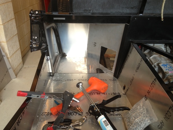

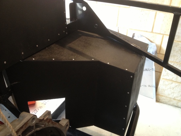

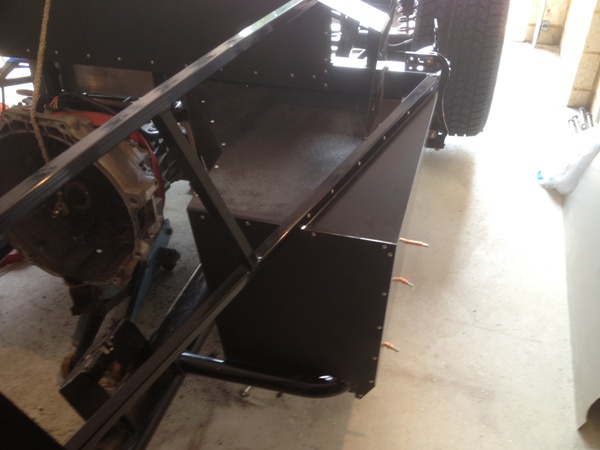

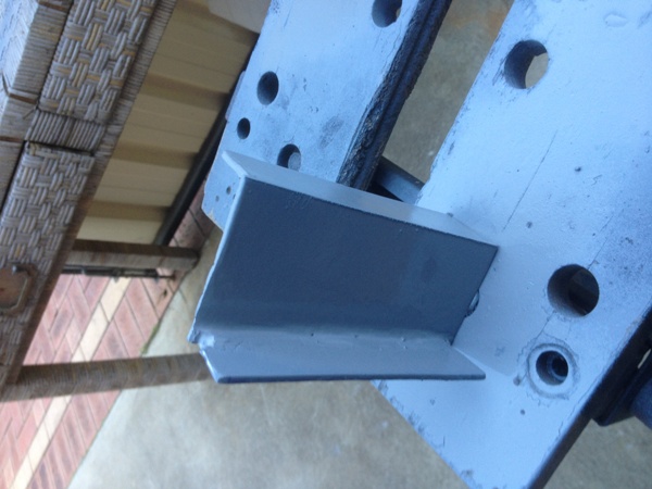

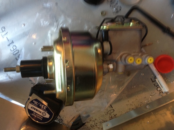

A small update nearly finished the passengers foot box will have to make up a cover for the starter motor

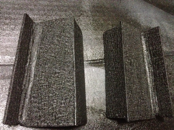

Received my new 7’ brake booster and XA master cylinder
Time to make up some booster brackets with a slight angle
Quick squirt of wrinkle paint just need to drill the holes

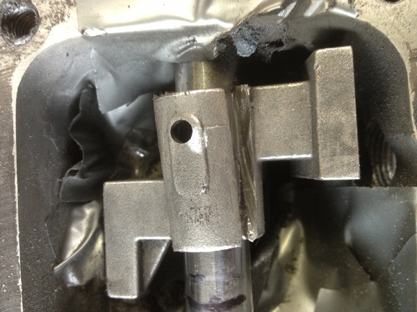

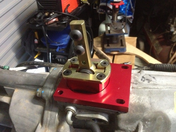

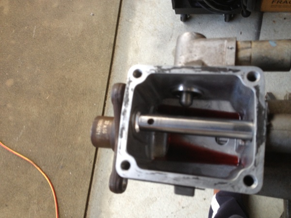

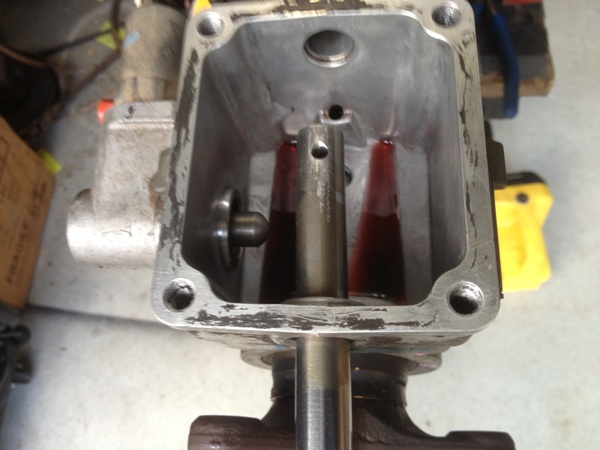

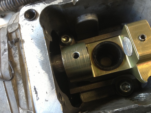

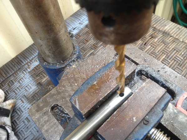

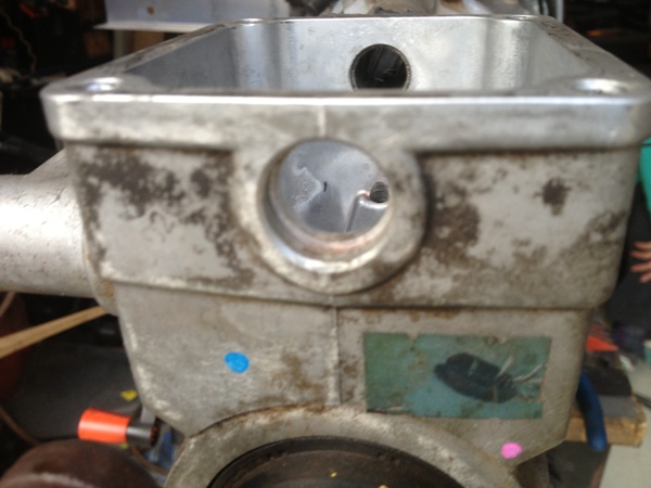

Received my Gearbox parts yesterday and spent last night looking on the internet to see if I could do it myself so hear it goes.
Taped out the whole area put a rare earth magnet under the shaft my god are they strong nearly lost a finger when it found the shaft. The grinding went well.
I knocked the small plug out of the end so I could remove the shaft for drilling
Drilling went very well took it nice and slow and sprayed plenty of lube
A little bit of persuasion and on it goes
Time to put it back together
Job done took 4 hours and I couldn’t see a single iron filling any where
