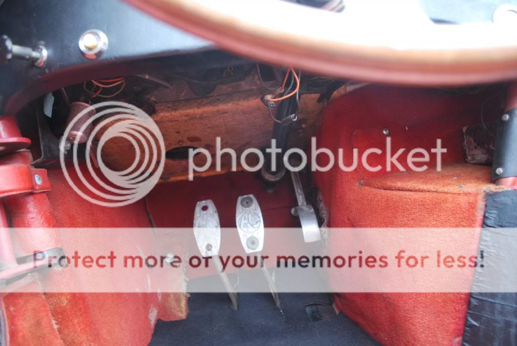

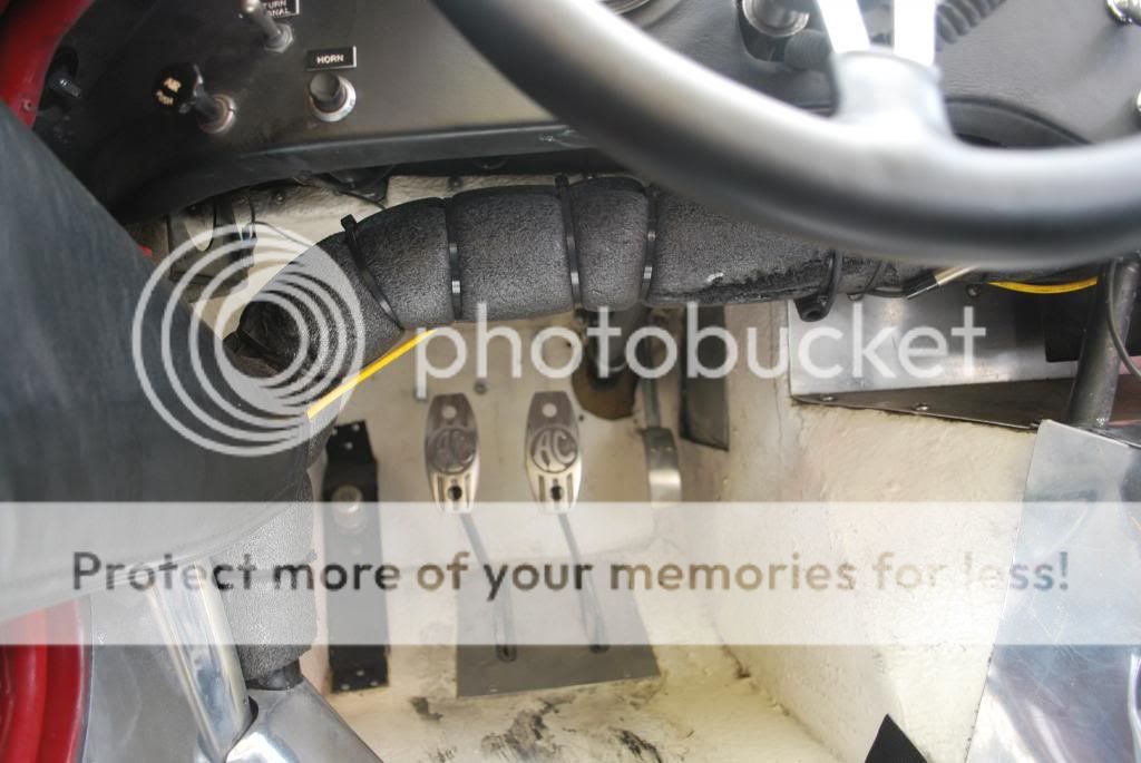

A slight detour to this thread … as noted above, not a lot of room in the foot box of a Cobra. Thought you might be interested, as here are (3) different CSX2000 Cobras with headlight dimmer switches. Interesting that even the race car kept the switch. Probably used now as a dead pedal.
Road Car #1
Road Car #2
Race Car
... now back to your discussion ...

Nice tkb!
So, if I DO install a foot switch, my cobra will be a more true replica than anybody else's! Ha!
