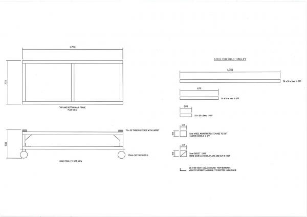

My build trolley came in very handy during the delivery and the unpacking stage. I made the top section of the trolley removable.
When we slid the crate off the Tilt truck we placed the bottom section of the trolley under the crate. This made moving the whole crate and kit very easy. Once in the carpark it took me about 2 – 3 hours in between the rain to unpack the Kit and move it off the packing crate and into my workshop.
Moving the body and chassis off the crate was pretty easy because it’s so light. I slide it off the crate and on to the top section of my build trolley, then jacked it up on to Jack Stands before sliding the trolley under the body and chassis.
