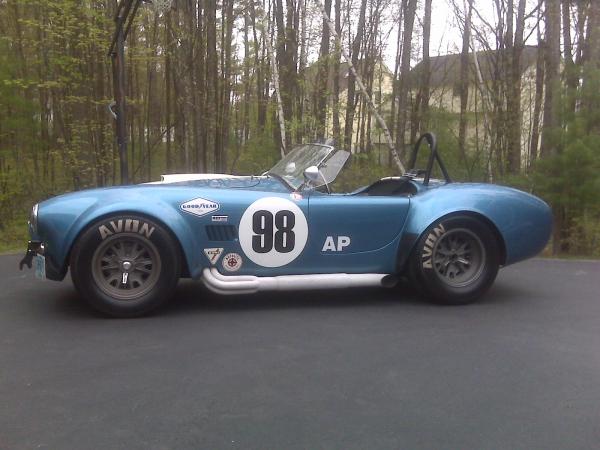

Old 04-06-2015, 02:46 AM
xb-60's Avatar
Join Date: Aug 2009
Location: Adelaide, SA
Posts: 13,152
That's 245/60 fronts and 295/50 rears?
Side-on picture would be good.
Glen
Old 04-06-2015, 03:34 AM
750hp's Avatar
Posts: 4,381
This is my favourite photo of the 245/295 Avon combination, with some nicely weathered in lettering...
