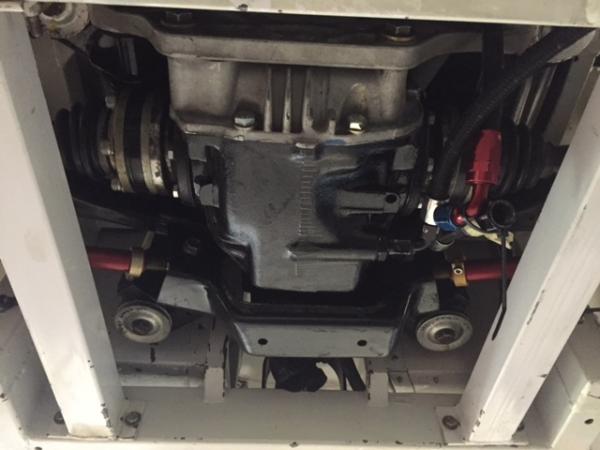

Well, after enduring another disappointing reliability issue at Nats 2015, Ive stripped everything out from south of the engine block!
Ive started with beefing the rear end. Ive managed to convert my existing mid case BMW M3 rear end to a LARGE CASE M3 3.2 our of their V8 and V12 coupe. Good for serious torque. Crown wheel has increased in size from 188mm to 210mm and I have increased ratios from 4.27 to 3.91.
The centres a monster. Had to fab a new diff carrier but have maintained all my 1/2 shafts etc which were already taken from the large case diffs specs and modded. A relatively easy and simple mod and I'm told I will never have to touch it again! After 6 mid case fails I hope so!!
The diff pumpkin nearly needs 2 blokes to lift it!

New rear end complete and fitted. Some fab work, a new cradle, and diff mod but all up we should be good for 700nm+.
http://www.clubcobra.com/forums/pict...ictureid=14482
Now to the pricey middle section. The GB.
