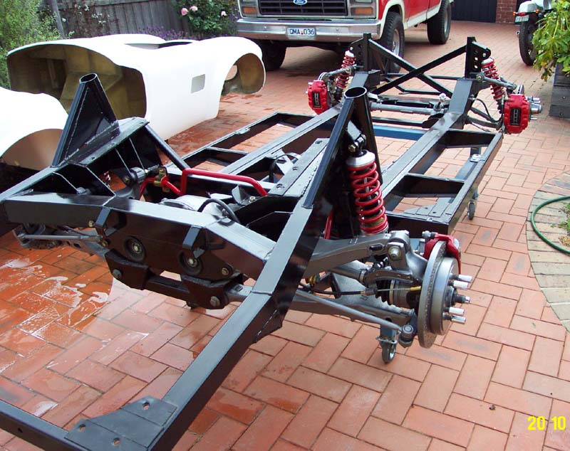

G'day LOWNLAZY , check out www.classicrevival.com.au . This is the car I've been checking out. Ian the owner of the company uses the complete IRS package out of the AU xr6-8. He has designed a beautiful car. The only gripe I have with using the Falcon IRS is the width of the rear end. If you like modern wheels and tyres , it won't be a concern. However if your like me and prefer a more original appearance, you can't maintain a meaty front offset on the rear wheels. I guess this would be a small sacrifice for what is a fantastic looking car.

There are a few pics of the AU IRS in my gallery. I'm very happy with the Ford set up. It's completely and easily adjustable for camber and toe in. It's also a double unequal length wishbone set up with CV joints in the drive shafts. I'm expecting the car to handle extremely well.
I agree with Stephen, these rear ends really lend themselves to the look of 17" wheels. Check out Sloth's car as an example...
My rear suspension:
