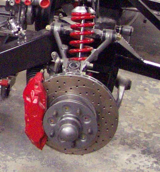

Hey Jason,
I may not be a technical guru, but I know what works well as apposed to what's s**t rotten.
I've got 4 pot Jag vented calipers with 16" wheels (the car's so low, I think the brakes are scraping on the floor - no comments Craig (Scott to the rescue)) and the car stops like a treat, no matter what you're doing.
I would certainly recommend the setup as no failures to date even when trying.
Who needs ABS anyway.
Pic follows
PCC (Peter Craig)

Peter, it looks like you're running the same front brake setup as me. Front disc
Mike Murphy
