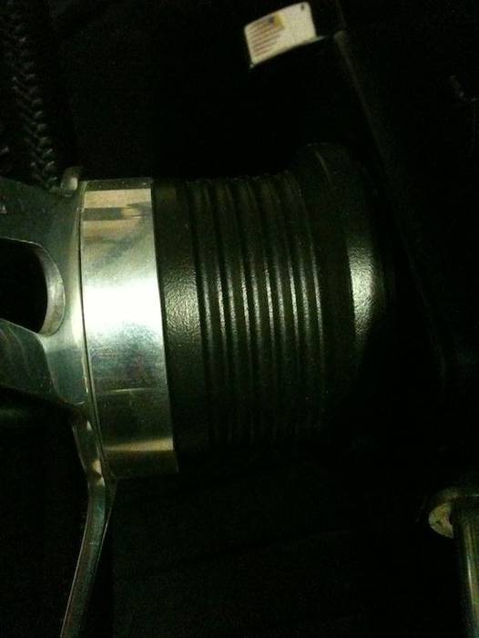

boxhead's Avatar
Posts: 5,699
Hey again Sambo, not a greta picture of what I am trying to show, I will search for a better one.
But here is a pic showing steering wheel and teh shallow adaptor for going from 6 bolt to 9 bolt.
Cruising in 5th
Thanks mate. Is that a 1" dish on the wheel? From the end of the spline roughly how far forward (towards back of car) does that put the wheel after adding the boss and adapter? Mine's already close enough - need to drink less beer!
