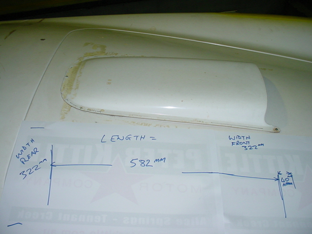

Whats the distance from the back edge of your bonnet to the the point where the scoop starts to rise off the flange and what length is the scoop?.

Hey there Les, it clean slipped my mind you where after those dimensions, well I am still at work so I raced out the back and did some measureing for you.
See attached pic.
Cruising in 5th

Thanks Boxhead. Near as damnit to identical.
The only diff being that 40mm extension on either side of the front of yours. Mine finishes at the 582 mm at the front without that extension..
