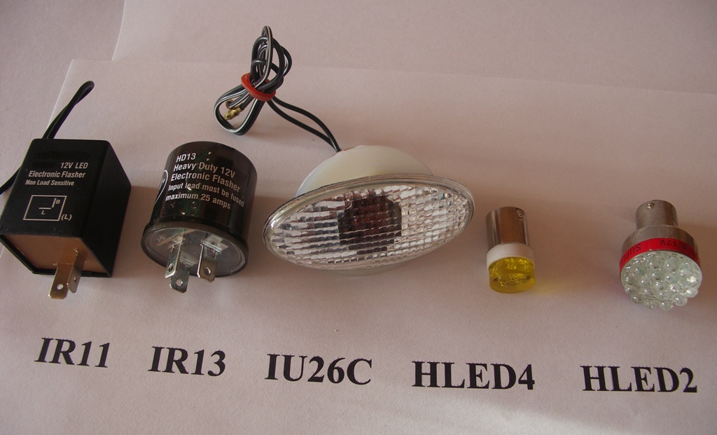

I sourced a Flasher can from Narva designed specifically for LEDs. It's an electronic unit that doesn't rely on the load to regulate the speed it flashes. I also wanted a square can that would plug into a standard relay socket. this keeps the wiring tidy. It's a fairly new unit to the market and your auto parts supply might not have seen one before.
It was a bit pricey at about $49 but it'll probably never need replacing and it solves my indicator headaches. I'll find the part number if you're interested.

Mike, I have the relay that is needed for led lights a no load unit it will flash one single led filament. I sell to the motorcycle trade for led indicators

Had a good chat with Barry on Thursday night. He's got some excellent wiring goodies from the Motorcycle industry that will work for Cobras.
He's got a flasher pack that'll flash LED blinkers no trouble regardless of load and it's significantly cheaper than the $49 I paid. He's got a good range of LED bulbs to suit our bayonet style fittings and some neat looking side indicators that are easy to fit and wire up.

Barry sent me a pic of the bits he can supply. The side indicators don't look like they are E marked but they may not look too closely at them anyway. I reckon they are a neat design and look t be very easy to install as they have a large nut on the back of them and you just need to drill a round hole in your panel work.
