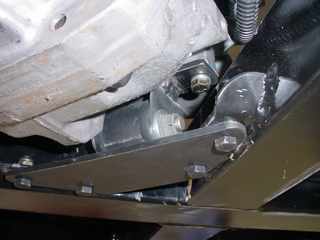

This is a simple way of mounting the box using a standard VX era rubber mount. I cut Ians plate and welded a couple of tabs to the side to bolt to the chassis. The holes through the chassis have crush tubes welded in place and take a M12 fine thread bolt. Simple but does the job.

That looks like a good setup Dale, very neat.

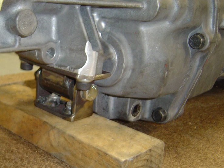

Here is the pic I found, was planning to do something similar.

Hey - that mount looks familiar.
Beejay, it is made from shackle bushes out of a hilux but I am not overly happy with it, But I do like the look of Cobbindale's mount.

Here's what the last couple looked like. Two bolts run up through the original X-Member and into nuts welded into the mount. Makes it easy to remove the whole thing from under the car. Unbolt the mount from the cross member and then un bolt the cross member. It's then easy to get at the bolts attatching it to the gear box.
Shackle bushes are Mackay rubber bushes and are pressed in with a steel crush sleeve pressed through the center.
The pic shows it bolted down to a pallet for shipping. It's not a new light weight wooden gear box cross member.
