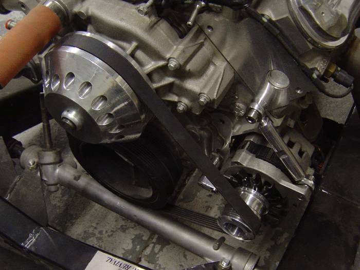

Aussie Mike's Avatar
Location: Sunbury, VIC
The minimalist approach
The alternator is an 80 Amp Delco unit sourced from a Japanese import wrecker ($55). Pulley is home made along with the mounting bracket.
The bonus was selling the original alternator for $150 which paid for all my materials.
Mike Murphy
Melbourne Australia
