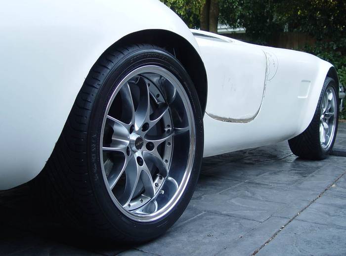

Cobra Make, Engine: RCM, 4 wheels, two doors
Posts: 704
Deep Dish
Gotta luv deep dish
My Cobra is a RCM (not to be confused with RMC or RC) made by Laurie Bongailas. RCM's are common in Vic but I don't think any have left the state. Btw the rear end is a shortened and beefed up Jag rear

Very nice Al.
Nuffin like the deep dish a jag ar$e end will give ya.
And.......
Those wheels look real trick.

Posts: 704
Thanks Les. on't be too long now before the wheels are turned in anger
