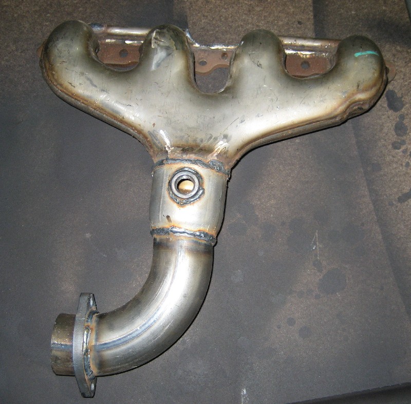

I built a pair of these manifolds for my under body system. They started as a pair of factory corvette pressed steel exhaust manifolds that I picked up cheap on ebay. I cut them down and made and new collector and put in an O2 sensor bung. The bend runs in close to the block and bolts directly to the Cat converter. The whole thing is modular and easy to unbolt. Easy to build, compact and cheap.

Thanks Mike but I did get the tri-wire exhaust system that is run standard on this motor and there is no way in heaven that these would have come close to fitting. I would presume there is something similar for the windsors but beyond the aftermarket huggers I haven't seen a similr beast.
