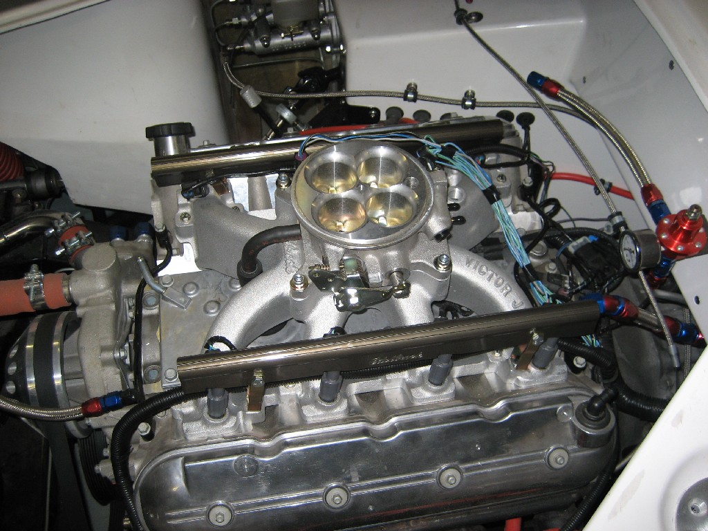

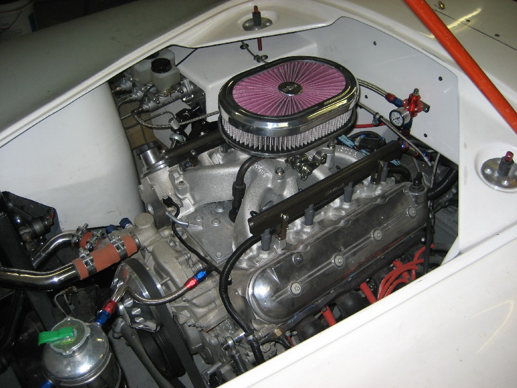

I've got it all plumbed up and I turned the key on the week end. It runs and idles beautifully with the new manifold on it.
I machined up a billet throttle linkage for it that incorporates 2 extra return springs. Its also adjustable so you can quickly change the return spring tension. It's wound out to the max at the moment as the springs are a bit long. I've machined the air cleaner base to take the Intake Air Temp sensor and the breather. The valley plate is an LS6 item and I've changed it slightly to make the PCV connection a bit neater.
Every thing that the factory manifold has plumbed or connected is there. The Carbon canister vent runs off the side of the manifold back to the purge valve mounted in the tunnel. The MAP sensor is connected to a vacume port off the back of the throttle body.
All I've got left to do is re route the wiring and shorten some of it but I don't want to do this till I've got an answer from the Engineer.
Very happy with the results so far.

Mike, very very impressive. That now looks like a cobra engine.
Well.....except for.......

Throttle response is great. The induction noise is wonderful. When you first fire it up the sucking noise from the throttle body is really loud. Once the IAC kicks in and regulates the idle this seems to quieten right down. I reckon I'm going to have to pull the under body system off and put my side pipes on this week end just to hear the thing roar.
The engineer I've been dealing with is Collin Young but I've been having trouble geting hold of him recently. He used to engineer Robnel's cars and he did Leeroy's CR as well. I haven't got any answer on this induction setup but I won't know if I don't try.
