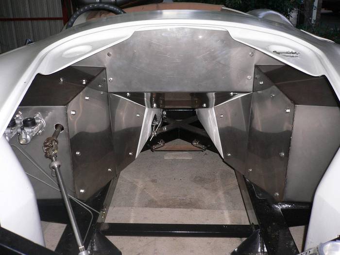

few pics of the progress Ive been making on the boot - the brushing (scotch briteing) and polishing need a little touching up after installing - but Im pretty happy with how its come up.

Hey Darrell, Im planning just black carpet, but where the stripes are have the carpet just turned on the grain - subtle. I did the work myself - Im no expert though, just more time then money! haha. Shaun made the battery box - top work as usual.

Thanks Ben - I made a bending brake a while back from some plans I found on the net:
It does an OK job on 1.2mm aluminium but I wouldnt want to go much thicker. The large curve I just bent around a fence post till it was about right! I made up lots of cardboard templates first though.

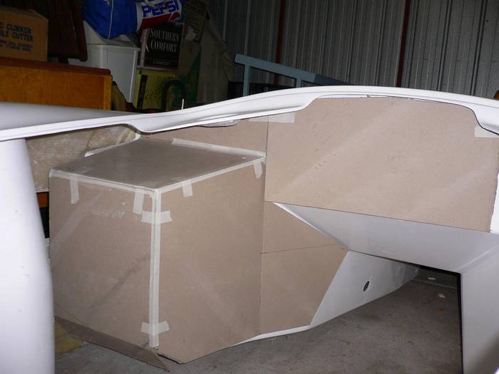

I made up a cardboard mock up of the battery box for Shaun, but I stuffed up a bit. I had it tucked nicely under the seat belt mount, but then realised (once I had cut the hole in the boot floor) that although it looked great, once the battery was in I actually couldnt lift the lid off over the battery (Number one in the dumbest things Ive done on my car so far) So I moved it further back (and patched the hole), but then it fouled wth the chassis cross member, so had to have Shaun cut the bottom off the bottom section and make it a bit shorter - Ill measure up tonight the final dimensions - I plan on using an Optima battery (like many) so sized it accordingly (I hope!)

I've actually used stainless in the engine bay. I wanted something a little more hard wearing in the engine bay and I got the sheet of stainless at a price a couldn't refuse
Like you mentioned, I also made extensive use of cardboard to make up templates and then took these down to my local sheetmetal place for cutting/welding etc.

I'm also impressed with your panels to block off the area around the tail lights. It bugs me that the backs of the light fittings and wiring is exposed on mine. I thought about making up some covers but your idea looks great.
Your folder looks like a handy tool as well. I might have to look at making one of them. You cant have too many tools.
