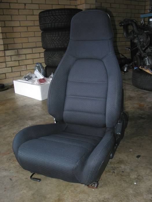

Well I thought I might have photos of the modified MX5 seat mounts.
This is all I have.
Pretty isn't it.
Notice no Cobra body/chassis in background. This is in the before chassis stage of the build. We had all drivetrain, suspension and lots of little things ready to go well before the chassis arrived. So all those guys waiting for chassis before starting the build, you can well and truly start your build without one.
Sorry don't have photos handy of DRB floor mods, they were done 10+ years ago before we had luxury and convenience of digital.
www.absolutepace.com
