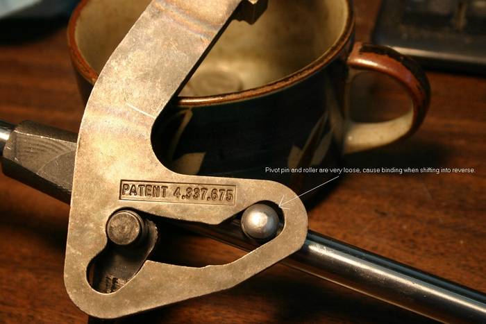

Check this pivot pin on the linkage for 'play' when you have it down. It appears to be a weak link in the T5. When it gets loose it can make shifting into reverse difficult to impossible. The pin handles reverse and 5th gear, 5th is generally not a problem with a loose pin, reverse is.
