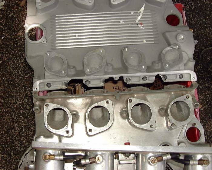

I believe that the original hi-riser intake was cast for the 58 mm downdraft webers, not the 48 IDA's, which had a smaller bolt pattern, although the bore centerlines I think were the same between the two carbs. I donlt know of any hi-riser intakes cast for 48IDA carbs, although if you could find an original intake for 58mm carbs, you could make an adapter plate for 48mm IDA's or throttle bodies.
Here are some pictures of what maybe you are looking for.
On the top is a new blue thunder 48mm IDA intake, with a 10 degree canted mount angle.
Below is a 1960's Hilborn Fuel injection system for a ford 427 with High Riser heads. The system consisted of two pieces, two banks of 4 throttle bores, of 2 7/16" (62mm) diameter, that are bolted to the top of the intake. I believe the intake has the 58mm weber bolt pattern and spacing. As you can see, the throttle bores are straight up, not canted at all. A somewhat rare intake. It has been polished, and no identification marks are visable. This should make alot of top end power. I unbolted one of the fuel injection throttle body castings to expose the mating surface of the intake.
As you compare the two intakes, you can see the larger bolt pattern of the 58mm weber intake, as well as the larger ports. There isn't enough of material on a 48IDA intake to redrill for a 58mm pattern.

Hi Anthony,
Thanks for the info. Is your manifold available? It would take some machine work, but I think I could resize to 48 and even cant the mounts 10 degrees. It is a nice looking manifold. You may be right about the size of all the manifolds of that day and you are right about the throttle bodies I plan to use. I will be using 50's from VeryCoolParts.com
Russ

Sorry, my manifold is not available.
However, I do know of another FI system like mine, although I don;tthink the owner is selling, as he wanted to bujy mine as well.
A couple of years ago, there was a hi-riser engine / cobra for sale with this exact set-up but converted to EFI, and I'm thinking the induction system or engine may have been separated from the car. If you can find a set up like mine, then you can use the throttle bodies as supplied, converting them to EFI.
Also, Algon made mechanical FI systems for Hi-riser heads as well, the only one I have seen had the throttle bodies (whiche were cast into the intake itself) oriented straight up.
