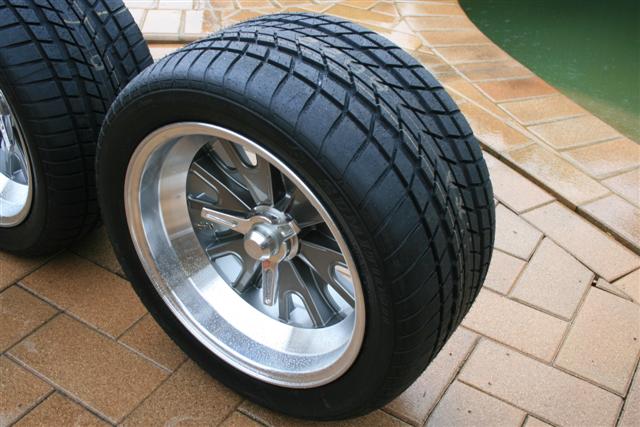

My rear 315/35/17 HTRZ Sumitomos on 10 1/2" Vintage Pin Drives. Fronts are 255/45/17 HTRZ II on 9 1/2" rims.

Who's rims have you bought and what sort of cost for the set and pin drive parts?
Stephen,
They are Vintage pin drives. I got them direct from Vintage in the States by Money Transfer. They were $AU2,697 plus $AU302.49 GST. That included the adaptors, freight and Transfer.

I'm a little confused, as the Vintage site seems to quote $1700US all up for four rims and adaptors which is less than $1900AUD.
Is your $2700 including the tyres or had I missed something off the Vintage price list?
I've got a mate importing a car later this year, so my bits could be shoved in his boot as extras at no freight cost as a bit of a saving.
Let me know on the pricing please.

Stephen, the rest of the money for Vintage Wheels is the cost of freight. Just watch, they tend to use BAX you can get stung with extra charges here like customs clearance, valuation, fuel surcharge etc. Then add your GST and the bank charges/spread and you get to AU$3k landed pretty easily.

So Craig if these rims disappear into the boot of a car in a container, I might miss all the financial fun you are describing?
But there seems to be a huge amount of extra charges if it's all feight and freight related, another $600, is that right?

Yep, or you can break the shipment up and send them separately via USPS(Post), you will save on shipping and there won't be any GST.
Bax Global that vintage uses tend to be on the expensive side, the quote you get from Vintage is about half of the total cost of the freight, you get stung with the rest of the charges when the goods land here.

Unfortunately, when I brought the rims. our $ was on the high end of 70 cents. No Stephen.. That price was just the rims, adaptors freight and GST. No tires, but I made up for it with a killing recently when I cashed in a stack of Aussie Dollars for 94 cents US.

Even at $3K they are a good buy. I paid $2600 for my rims and another $1200 for the adaptors from local supliers.

I bought my Vintage wheels back when the dollar was around the .70c region. I think all up it was just over $3000 - I got stung with extra fees and charges at this end, thanx BAX - and the best money I ever spent on the car I reckon.
I haven't seen anything that's made in Australia even come close to the quality and finish of the these Vintage Wheels!!!
