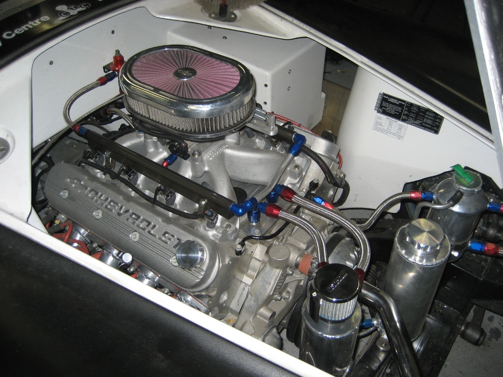

You can see the number in front of the drivers side cylinder head before the rater pump.
