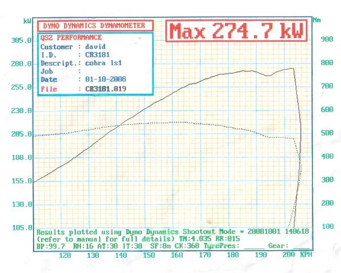

One of the "jobs" I wanted to get done was a chance to get the Cobra dyno tuned, as the car was still running a mail order tune from ChipMaster in WA.
Gav had organised a guy to do it for us on the Wednesday before heading to Goulburn.
My car span the dyno to 266Kw with the mail order mafless tune, the dyno guy plugged his laptop in and could not communicate with it, turned out the guy from ChipMaster had locked it.
I contacted him and advised what our problem was and asked if he could supply either the means to unlock it so it could be fine tuned or if he could email the tune to me so if we did wipe it, we could atleast reset it.
To all his answer was NO, he told me to send the ecu to him and he could return it back to a stock tune for free.
So he was more than happy to take my money (cant remember it was either $400 or $600) but did not give a rats arse that there was no way I could get the car to him for fine tuning.
So if anyone asks me I would say steer clear of him.
So Gav's guy had a spare ecu there, we fitted it and he set a base program in, adjusted fan temps removed VATS etc.
After some fine tuning below are the final results.

Very nice numbers (368.4rwhp) - bet you're grinnin

Very happy LoBelly,
Due to the amount of horsepower, it gave me a little extra speed on the main straight to get away from Churchy.
