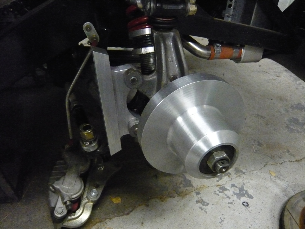

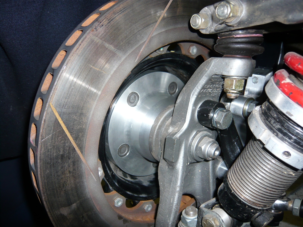

I've posted these pics before but here's a shot of the new hub with radial mount caliper bracket behind it.
Here's the hat style rotor mounted.
6 piston radial mount caliper bolted up
