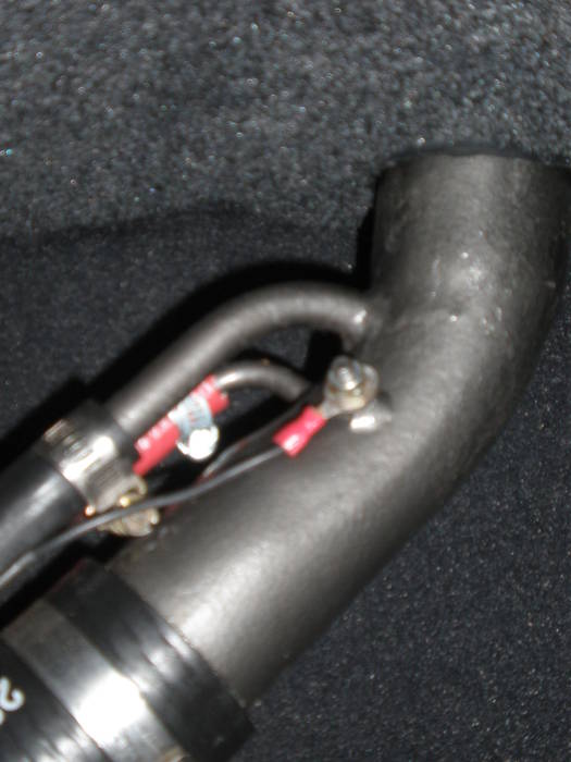

The filler pipe I have(which was supplied from Warwick Harrison) was piece of rubber filler hose(genuine gm part), a piece of exhaust pipe with a bend(don't know the angle ) on the end and an unleaded insert to suit a holden fuel cap.
These days an unleaded insert might not be required as you can't buy anything else.
I read a post on another forum using silicon pipe for petrol filler hose. This fella cut a piece of the silicon hose and soak in a small amount petrol and after a couple of hours the silicon had expanded to twice the size.
Warren

That looks a lot like VN Commodore filler pipe cut down.
I'm using the Commodore fill pipe too but I've used a couple of bends welded in to rout it to the right spot. This way there is only one rubber connection and it's tucked out of harms way.
The carbon canister is hiding behind mine as well.

I measured the angle of the steel pipe and it was around 45 -50 degrees. The unleaded adaptor fitted in the end of the pipe and then tig welded.

Warren,
Great photo. Can you tell me what the two hoses go to?
I think one goes straight to the pipe that is already part of the tank, but where does the other one go to???
Schipps

Mick,
The black hose goes to the tank beside the filler and the red hose is the line that returns to the carbon canister. I used a pump from a V8 VZ ute. These pumps have a outlet and return, but no vent.
