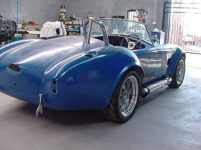

Hi Greg
I am a fan of just one hoop on the drivers side.
Mine is a three leg but the rear leg that normally goes through the boot i have cut of so it sits neatly on an ally pad so to the untrained eye it looks like it goes through,
I have not got a recent pic so i uploaded this one
Regards
Paul
