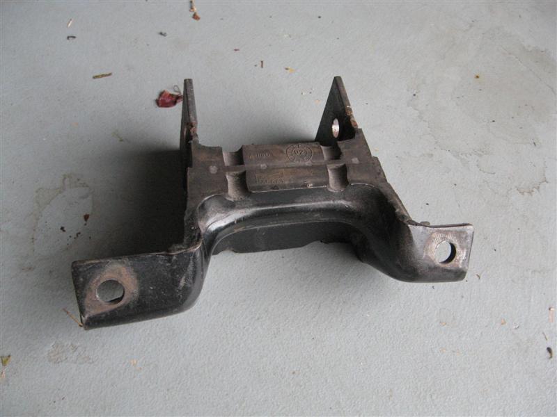

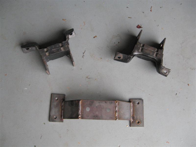

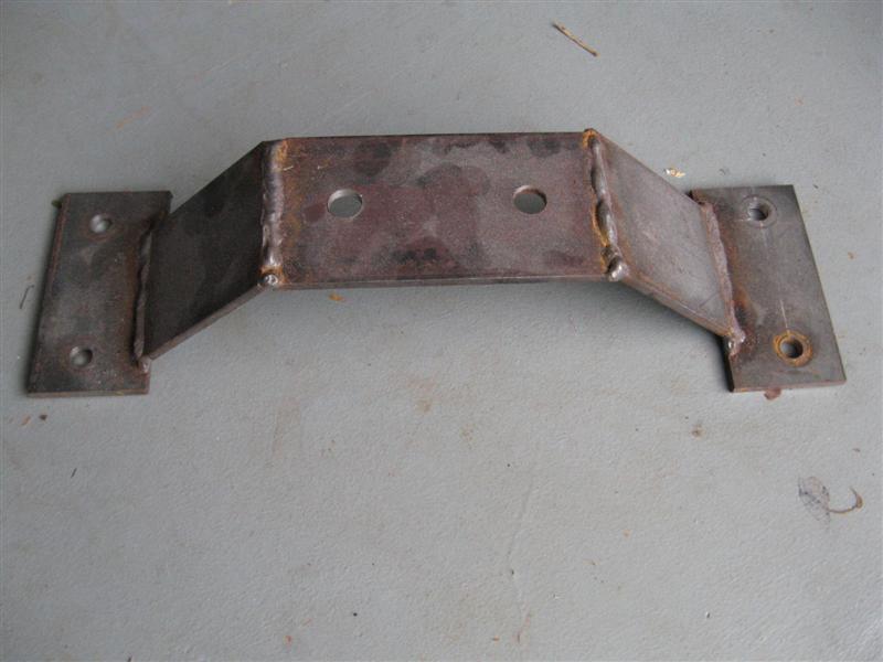

I have a late Harrison with 302 HO. These are my engine and gearbox mounts for what its worth. I got them from Warrick.
Cheers Bob

Ive got the same engine mounts on my 302, they are very early Ford mounts.

Yes those are the early mounts I was talking about, though looking up evilbay they are described as suiting XR-XE & ZA-ZK V8 cars.
I think there may be any alternate that has two bolts facing down to lock the mounts to the chassis but those aren't generally used in the cobra to my knowledge.
If getting these and modding your gearbox mount does the trick, just bite the bullet and your tongue and do the job so that you dont have to worry about the engine bay fit.
Obviously too if they lower your engine and gearbox, it will help with the car's handling, these being some of the major weight components, and for this reason alone it would be worth the extra effort.

Thanks again fellas, specially pics from Bob.
It looks like my mounts are the same, bit hard to guess the height of Bobs with a pic but mine are about 110mm from middle of tube to engine block mount face. Does this sound anything like yours?
I hear you Stephen but lowering creates more issues than just the gearbox mount as the main pulley on the crankshaft sits around 2mm directly above the front cross-member, so the whole engine needs to to also move back about 50mm to clear this. Plus I've got around a 3 degree angle on the drive shaft (the nissan rear end is higher than the box output shaft) and I reccon that by dropping the engine more that this angle will increase beyond the recommended angle.

Middle of tube to engine block mount face is 85mm on mine. This is a vertical dimension from horizontal face that bolts to block and centreline of tube. I can post a sketch if this is confusing.

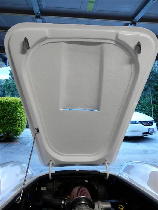

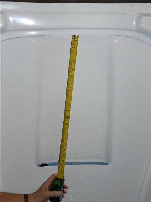

Originally Posted by byroncobra View Post
Out of curiosity how big is the cutout in the bonnet when fitting the scoop, as my car wasn't supplied with one. Warwick tells me that all his cars come with scoops, mine's disappeared with the last owner apparently.
Greg,
Have attached some images of my bonnet scoop for your reference. Hope it helps.

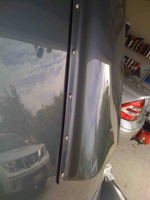

Greg, Warwick has a template for that I believe. I kept my scoop separate and attached it with SS "rivets" (in gallery).

It does look like your mounts are an inch or so shorter, I may be able to give thought to grinding a bit out of the crossmember as one other guy had to do according to a past post. Perhaps this is to much of a hassle to just gain 25mm.
Bob, that cutout of yours is too small to accommodate my throttle body, maybe I'll just fabricate a larger scoop.
