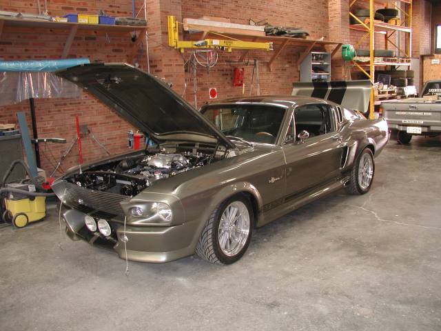

blck stripes like this one tooo???
took these guys a full day to mask up the for the black

Sideshow, I cant get that picture up. But hopefully this will come out.
http://i418.photobucket.com/albums/p...braColours.jpg
This is a car that I saw after I had decided to go with the colours.
