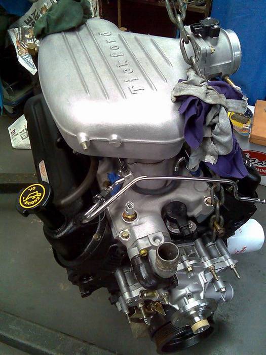

The rebuild is still moving along slowly and the reshuffle of the various bits at the front of the motor is nearly done.
Have had Marty move alternator to passenger side, the coil packs are bolted to the firewall behind the motor, the support for the new tensioner is almost done.
This work has now all allowed the standard Ford thermostat housing and radiator hose attachment but now with a radiator cap attachment to be fitted back onto the motor. I can't recall who I owe a beer for this wonderful fitting....don't all put your hands up at once!!!
Anyway listening to advice and knowing some bits are medium term duration I've had the standard plenum polished for a bit of bling whilst I work out my real intake manifold arrangements.
Again through my hot rod mate, he put me onto his polisher and I'm very happy with the result as follows:

My question however relates to the drab standard rocker covers on the AU as I'd like to instal a pair of the finned alloy covers stamped "Cobra Powered by Ford".
I'd look to get a pair with the black infill paint and think this might nicely offset the rear view look of the plenum's polished and unpolished segments.
I know I need to be careful about the height of these to get under the plenum on the driver's side, question is does anyone know the right version to buy?
Better still does anyone have a pair of these covers to suit that they want to sell? Let me know please.

http://www.clubcobra.com/photopost/d...um/NASSTY2.JPG
Just re-read this thread and I think I've mis read what coves you actually want. One of mate's cobra has roller rockers and the covers you're after. I'll ask him and get back to you.
stephen low 06-26-2009 07:00 AM
Actually Al with all the hassle of achieving what I need, I'm actually already looking to whip off the covers and simply get them powder coated black like you have shown.
For my engine the advice at this time suggests you have to space out the plenum to get covers that fit the rockers to then fit beneath the plenum. These covers are approx $310 a pair to start with.
At least your pic has given me an indication of the look - thanks for that! happy to hear from your mate though.

My mate used the standard ribbed cover you're after (originally with a gt40 intake manifold). His has Ford Power on them but they were available woth cobra as well. To make them fit he had to do two things. On the inside of the cover there are casting "pins" that he machined off which the gave the clearance for the roller rockers and to fit the AU cover gasket, he machined of the lip/step around the base of the cover which fits over the head.
These covers weren't anything special to fit roller rockers he just modded them to suit.
