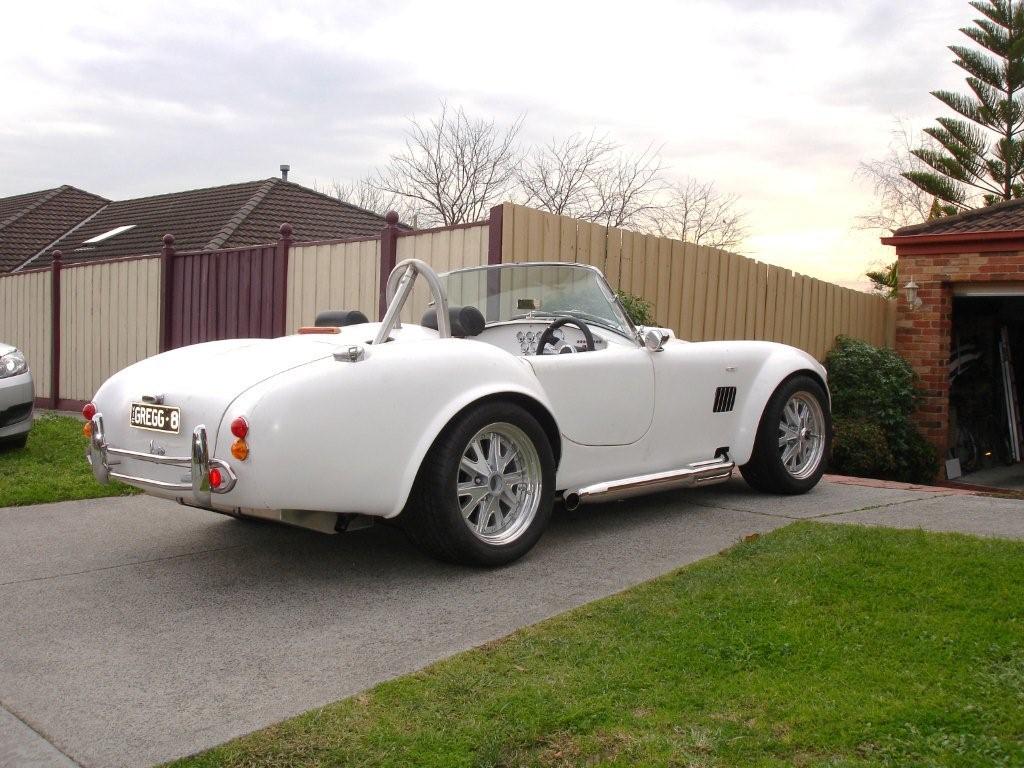

Hi All,
Just finished fitting my side pipes (sorry fake), and Roll Bar.
The side pipes I got from Warwick Harrison - I gave him my CR measurements and he made them up. Polished Stainless. Good quality.
I made some custom brackets to suit and all appears ok.
The Roll bar is from Ian at CR. In the new chassis their is a rear mount in the boot. good and bad - Good as you dont need to make a bracket, Bad - you need to make a big hole to get the post through so my hole on the top of the deck is rather large so I need to make a wider bezel for the rear stay.
Now need to work on which method to use to attach Bonnet Scoop. i.e. screws or bonded - open to suggestions here.

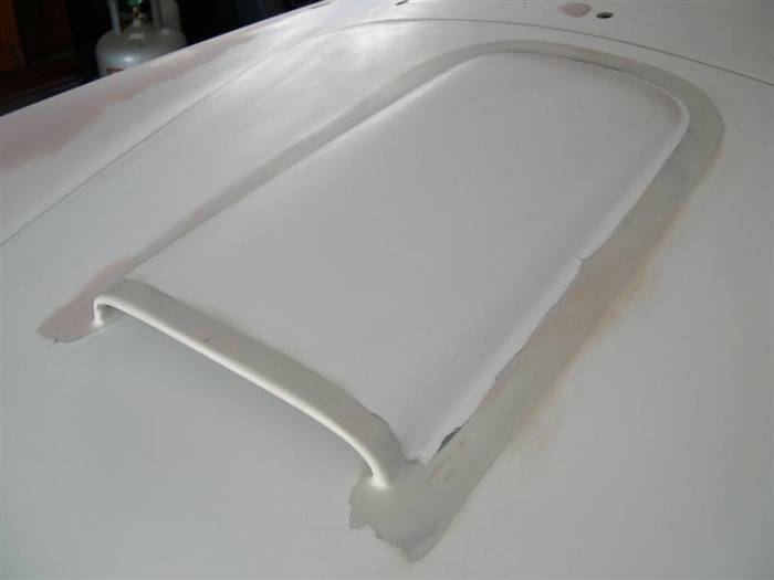

Personally I like the screw/bolt/rivet down look and I had to get a bigger scoop when I changed engine.
Fortunately, Doug Pearce makes one specially for RMC's - I dont know if he does Classic Revivals but it might be worth a call.
went from this..
to this..
I like the style/look but now I have to match the paint...
So, if, like Phil, you think that you'd prefer a different scoop then getting it now is definately the go.

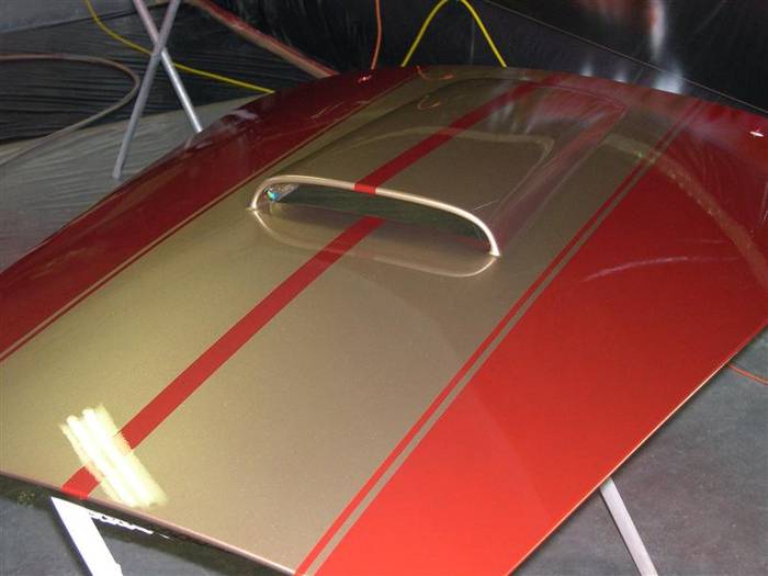

Cobra Make, Engine: Classic Revival.
Posts: 215
Hi Gregg,
CR with bonded scoop but not Ians. Purchased from Don at Snake Bite.
Cheers, Dale.
[IMG][/IMG]
[IMG][/IMG]

Used the rivet look similar to Merv's. about 100mm spacing.
Used Screws with nutserts to keep it simple.
Looks good. IMHO
Had to repair a hole from a previous location of the scoop (had it too far forward).
will post a shot when I get one.
Just wating on some fibregalss resin to cure a little before fixing the holes and my rear roll bay stay hole that I buggered up.
The last hole I had to make and I stuffed, murphy's law. I suppose I had to learn how to fibreglass sooner or later.
