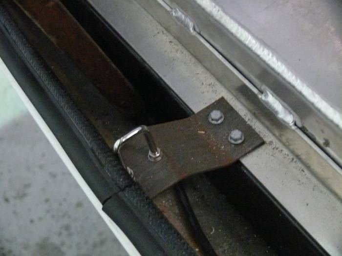

They are just the standard round reversing light that you can get at Repco - maybe they are a Narva. Probably for a trailer. At least 21W for ADR. They are mounted/screwed on to the black chassis rail in the pic below and with or without their lenses, they give off a lot of light through the Falcon lens that you have fitted from the inside of the holes cut in the body (e.g., with Sikaflex). I used two lights, one behind each lens. That way the only thing on the body is the Falcon lens.
