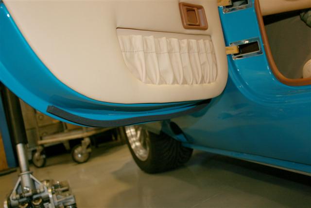

I have removed the Pinchweld with the rubber buld on the side and replaced it with standard Pinchweld with no rubber bubble. Also had the interior door handles and Pinchweld coloured to match the trim. Here are three pics... Check out the difference when compared to the photos at the beginning of this thread.

That's pretty much the setup we run on our CRs. There's no lip to attach a pinch weld door rubber to so adhesive backed neoprene is the go. You cant see it unless you look under the door.
I don't know why we worry. It's not like it'll keep the rain or the wind away. I think the rubbers are more to stop the door rattles.

Looks great Baz. Those chrome inserts where the hinges come through, are they custom or can they be bought? Same design as Harrison in that area.

The polished bezels surrounding the door hinges are custom made. They can be obtained through Neil Streeting at Street N Track on (02) 9520-5006 or 0410343136 or by email to streeto@tpg.com.au.

Very nice Baz! Much more discrete!
