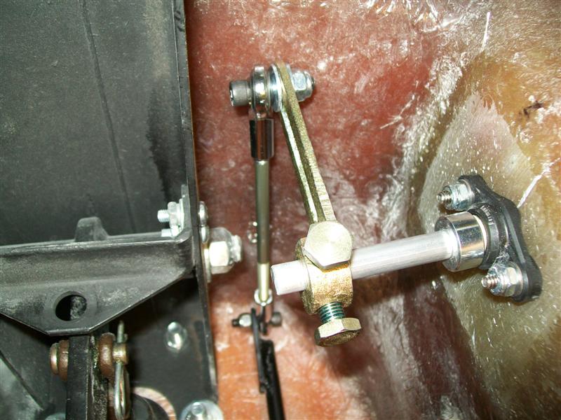

After a long evaluation. Longer than I wanted. I decided to go with Larry's design with a minor modification. I'm going with 1/4" rods and chrome rod ends. I also added an extra layer of fiberglass where the bearings bolt through the firewall. It was very tempting to just go with the cable but Larry's design was just so logical.

OK, I went with mechanical linkage based on Larry's design.
I cut off the end of the pedal rod and welding on a bracket I made to accept another rod end. I went with 1/4" ends and 1/4" stainless rod to the carb. I lucked out and stopped by metals supermarket and they had some the 1/4" X 5 ft. stainless rod in their remnant area for 3.00. I used the two bolt igus bearing EFOI-06 and put it on the inside of the foot box. I also added a rod collar on the inside so the rod can't slide. I still have to make a return spring bracket. Thanks again Larry.
