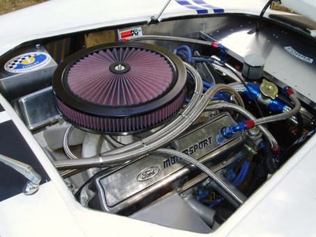

I agree. I have a 351 stroker to 383 about 400hp and yes I've added that 150hp in a bottle - approximately
...just stick it in your boot/trunk
The engine bay with the 351 block - set well back into the firewall.
Bernie
