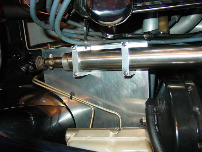

[IMG][/IMG]Heat shield for brakes:
Hears how I did a heatsheild for the master cylinder on my car, I machine two clamps out of 6061 alu with a bore of 1.630 and clamp to the stering housing with 8-32 machine screws .then bent and cut 032 alum for shield . paint with heat paint, what a differance this sheild makes.see pics in my gallery.
I can remove and install in less than 3 to 4 min .
Ed

Just curious....the people that are having problems, what size engine are you running and do you have ceramic coated headers? I'm running a 302 with ceramic coated headers and haven't had a problem yet.

I'm running a 302 with ceramic coated headers also and after hard running for a while the master cyclinder is hot, The sheild should make the fluid last much longer.
Ed

Does this shield also covers the clutch master cylinder?

Just got mine from Ed. Installed easily, will have to wait for the next rainy stretch, pull it out, and get it painted or coated.
Good product Ed thank you!
