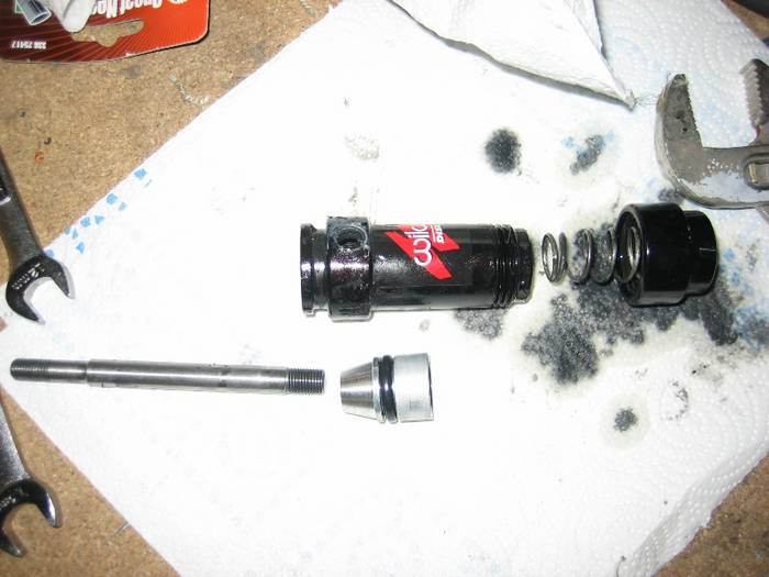

 On Sat, found a puddle under the car. My Wilwood slave leaked out the front. I took the slave apart and also found that the rod was starting to back out. I think I will try thread lock first as I am not sure how easy it is to drill the cone for a locking pin.
Does have a guess at why it was leaking? I was thinking the seal has gone bad..?
Does anyone know what the Wilwood slave rebuild kit consists of?

Will try posting the pic again...

Mark, you can also get a rebuild kit for the Wilwood Slave cylinder at Summit Racing:
http://store.summitracing.com/partde...5&autoview=sku
It's fairly easy to rebuild.

My Wilwood came apart twice, both times on the track. After the first failure I used locktite, but I think the brake fluid go to it.
I replaced the Wilwood with an almost identical product but at half the price form Speedwaymotors.com. The rod is "peened" to the piston.
JayB

I think I would take apart the slave cylinder. If you just take the rod out, and put thread lock on it, you may get threadlock on the seals. Also, you will not be able to keep the cylinder from sliping in the slave housing when tightening the rod. I would also buy the summit rebuilt kit if you have the Wilwood Slave. I think its like 13 bucks. Then you will have new seals and will not have to worry about any leaks in the near future. Hope I am understandable, had a few drinks
