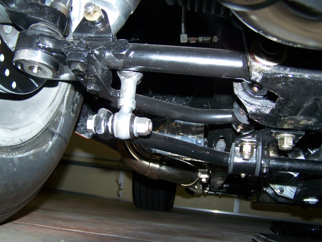

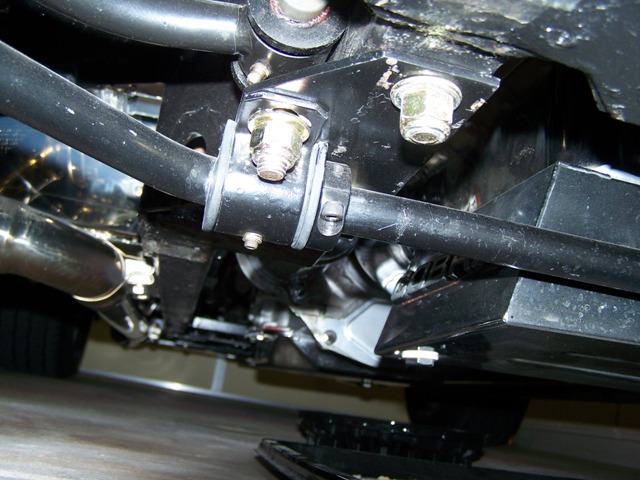

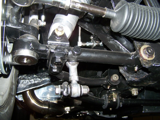

I used an MGB front sway bar, 7/8" -23mm, which, width wise, fit the front tubular lower control arms perfectly. Assembled my own links and used aftermarket/e-bay poly bushings and mounts for the sway bar to frame mount.

Hi Bulldog and MGM. The best source for info to begin with for the MGB front sway bar is Moss Motors, then e-bay. Lot's of info out there.
Moss Motors 7/8" front sway bar for all MGB's is the same for 72-80 and part number is 454-955.
Lots of used stuff on e-bay.
Here are a couple of pics.
Greg
