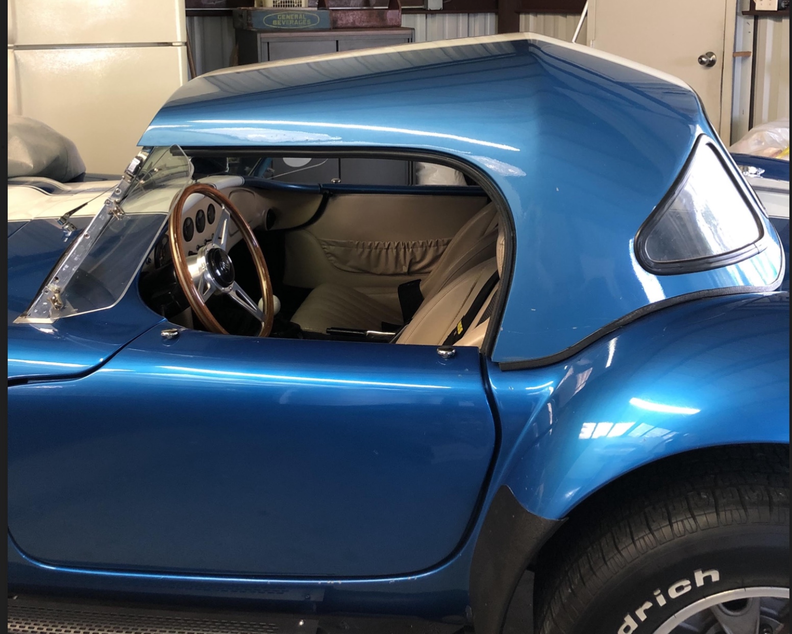

I am looking for info and photos of the Classic Roadsters Cobra hardtop with details about embeds for windshield clip mounts and rear body mounts
Checking if it’s Cobra hardware and what’s used for body seal and top to windshield seal
This is an original Classic Roadsters top mould
There’s three pieces easily fitted to each car
The plan is to make a top to restyle and use as a plug for a new mould
Crate up the like new condition original mould
Edit: added top photo from Bulldog

Sunmam I have a classic roadster hard top will take some pic of it and try to send them; this is Bulldog I haven’t poasted in a good while,

Great I am wanting spacing and what bolts are used for windshield and what are used for body mount hardware. What’s used for seals? There are 3 pieces and I’ve figured out how to fit them to car. Well not me, DV posted about fitting top. Were you involved with fitting your top and have some info? Same here I haven’t seen you for awhile, thanks for responding

Alfa02 and Sunman will try for those pic tomorrow hope I can get them to you I just so happen to have the top on car now, Tom I am still kickin recovering from a boating accident in a July almost severed my left thumb two operations later it’s healing should get some use back;

Sunman I got you’re e mail address and sent the pictures I hope they went through not to good with this computer stuff if you didn’t get them give me a shout ;

I sent you a phone number But I did get e mail. Thanks
I will get these pix into my gallery
The old wing nut welded to all thread trick for body bolts, nice touch. Camloc draw latches and no bolts inside on windshield, great

Sunman glad you got pics if you need aNything else let me know hope the pics help.

Bulldog everything is great on the pictures. I can upgrade body bolts and maybe find a smoother looking clamp latch for the windshield. There are a few fiberglass fab shops here going to check prices to have one chopper made. Maybe hand lay it.
Rear coil over mounts almost done will post pix soon
Thanks again photos made it a lot easier then I imagined

I am putting the hardtop photos in the gallery will email you when it’s done. There are 3 pieces to the top. The body mount strip and inner windshield header could help your refit maybe. Could do just a front top strip with latch attachment embeds. According to a post the top is fitted to windshield then inside header strip bonded in to fit
